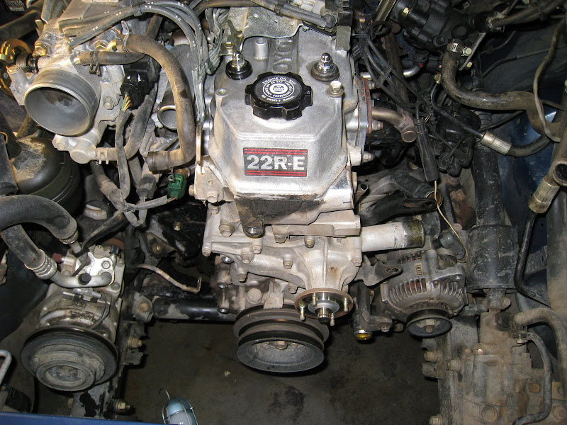

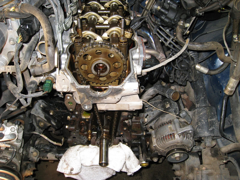

I tackled changing out the timing chain guides in my truck and I wanted to post my experiences to make the job easier for someone else.
Short background: I have a 1994 extended cab 4x4 truck with the 22RE with 80K original miles. Last time I set the valve clearance, I noticed that the driver's side guide was cracked. (see pic) Luckily it was all still intact so I didn't have to pull the pan to fish out plastic parts. After hours of searching on this forum and others I finally felt confident I could get the job done so I ordered the kit from Engnbldr.com (Guides, sprockets, chain, tensioner, oil pump, water pump, chain cover, all seals and gaskets) Parts and service from Engnbldr was excellent. I didn't pull the head either.
Here is what I learned:
1.) The magic rope trick will stop your engine from turning so you can break loose the crank bolt. You take the #1 plug out, rotate the engine around so that the #1 piston is at TDC and then you back the piston down about 2" from TDC and stuff the soft piece of rope into the cylinder through the spark plug hole. Rotate the engine so that the piston squashes the rope. Unless you are strong enough to pop the cylinder head off, the engine will not turn. Break loose the bolt with a high quality 1/2 drive 6pt 19mm impact socket ($8.50 craftsman), a high quality 1/2 drive breaker bar (mines about 24" long). I had a piece of pipe to extend my breaker bar another 18" or so. Break the bolt loose and then you can pull the rope out. My dad uses this trick when he works on his Ford 8n tractor. This method was so much better than building your own SST (this technique wouldn't have worked for me because my pulley was way too deep. Maybe they aren't as deep on earlier models.) or using a chain or even the lodge the breaker bar against the frame and bump the starter method because I could use the same technique to break loose the bolt on the cam gear (and to re-torque them too). My dad says he has heard to the rope trick used to break the seal on a really stubborn head on those 8N tractors.
2.) Follow the instructions from 4Crawler. The write up was great. I didn't drain my oil but otherwise I followed the instructions to the letter.
3.) Take lots of pictures and especially of the power steering bracket and the alternator bracket. I spent 20 minutes solving the jigsaw of how those went back together because even though I had taken lots of pictures I didn't get a good one of those.
4.) Label everything. Every single bolt had a note about where it went. Even the ones that looked identical just in case. Make a note of how all pulleys, gears, etc came off.
5.) I think getting the distributor back on the right tooth is a bit of luck. I was ultra careful and I was positive I had gotten it back on exactly as it was before but the truck wouldn't start. I moved it one tooth and it started. So just be ready for that.
6.) No matter how careful you are, you will miss at least 1 bolt on the timing chain cover. If it doesn't come off with the tap of a rubber hammer, chances are you still have a bolt in there somewhere. I missed the one on the backside on the drivers side. If at first it doesn't move, check, check and re-check.
7.) Make sure you know the torque specs for everything. The engnbldr kit comes with instructions saying not to over torque the 2 bolts on tensioner body. 12ft-lbs is all they need. Too much and the tensioner body warps and the tensioner will have a very short life and your engine too.
8.) I measured both the new and old timing chain and I could not detect a difference of 1 mm between the chains on 17 links. So I am thinking 80k isn't enough miles on those chains to even show. Granted I did it using a ruler and not a caliper. I hope this means I can make it to 200K without having to do the job again.
Links to pics: (I couldn't figure out how to embed them in the post) Gallery 1 and Gallery 2

All good tips.....the rope trick is interesting, I've never heard of that before.
I chuckled pretty good at number 3, because I did the same exact thing when I replaced mine TC a couple of years ago.

hell, your driver's side guide looks GREAT compared to what mine looked like

Also, a trick to get that dizzy dead-on; make sure the #1 cyl is at 0 degree TDC, and slide the dizzy in with the rotor pointing exactly strait up, and as you push it in let it rotate to the left worked flawless for me the first time during my rebuild
