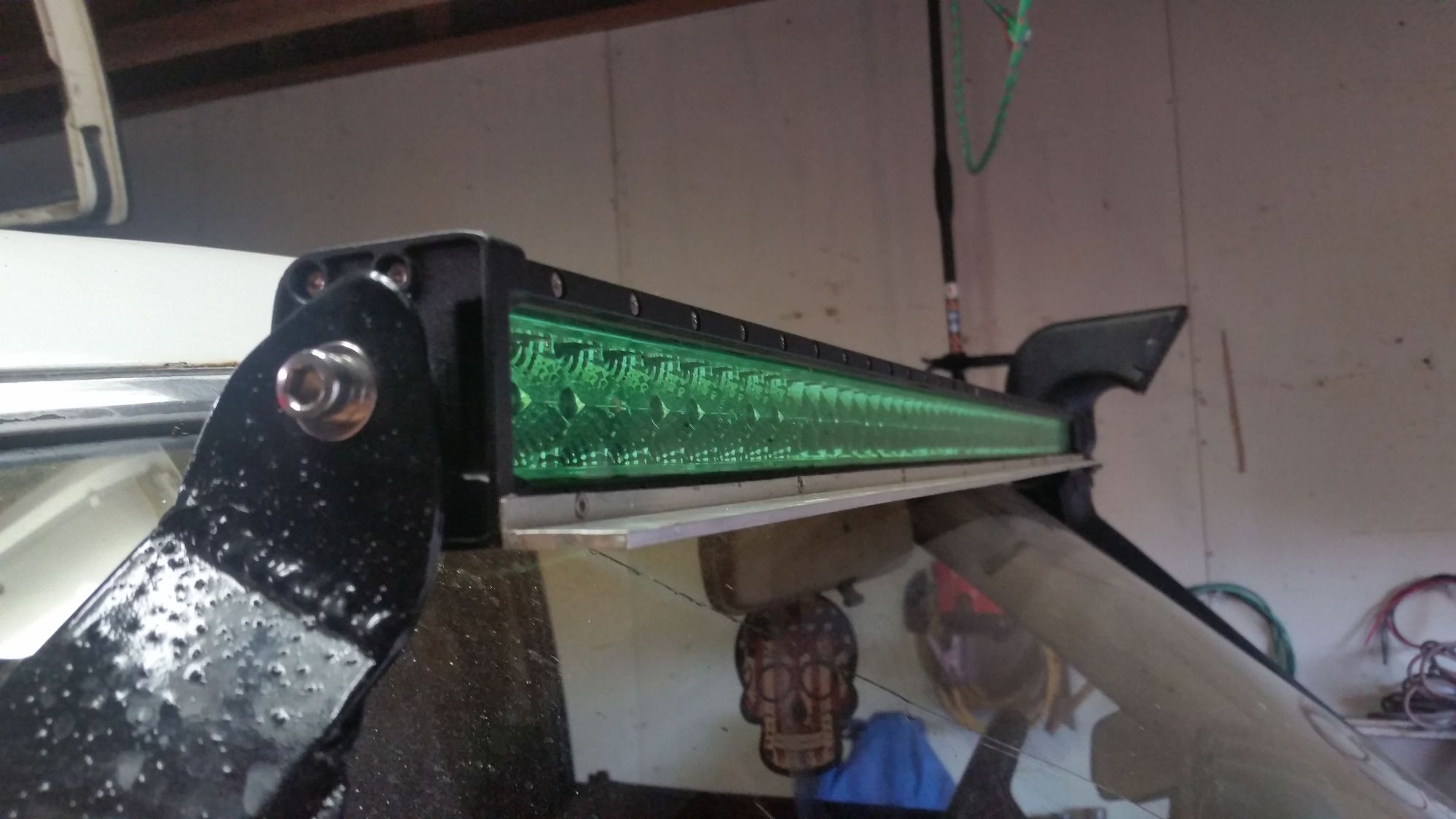

DHWRIGHT Aug 8, 2015 11:40 AM
https://cimg1.ibsrv.net/gimg/www.yot...4868a4cd8b.jpg
https://cimg4.ibsrv.net/gimg/www.yot...c5920fc280.jpg
I just made some that mounted low on the windshield so limbs don't take it off in the woods. used 12 6x1.5 mm bolts with well nuts.

DHWRIGHT. that is a nice solid mount, i'm not into that to my body but love the creativity. and i have looked into Dave's off road stuff for the mounts. also how did you get the different color lenses for the light bars looks sweet.

DHWRIGHT Aug 9, 2015 04:15 PM
The glare was only bad in the rain so I built a little visor to keep the light off the hood.
It is just green head light tint.
having to drill 12 6mm holes in the windshield pillar sucks but all ready had holes in other side for snorkle. Plus had to drill hole to hide wire.
https://cimg7.ibsrv.net/gimg/www.yot...abbdbeb312.jpg
The visor I built during the test fit before I cleaned up the edges.

DHWRIGHT the green tint looks good. how does it effect your light color? or is it still white?
wberry85 those do look nice probably plan on getting some from him
DHWRIGHT Aug 11, 2015 10:54 AM
I tinted the top one 1st and then compared it to the bottom one before I tinted both and there is hardly any noticeable difference between the two when on. I was hoping it would be green to stand out from all my friends when riding but its not.
