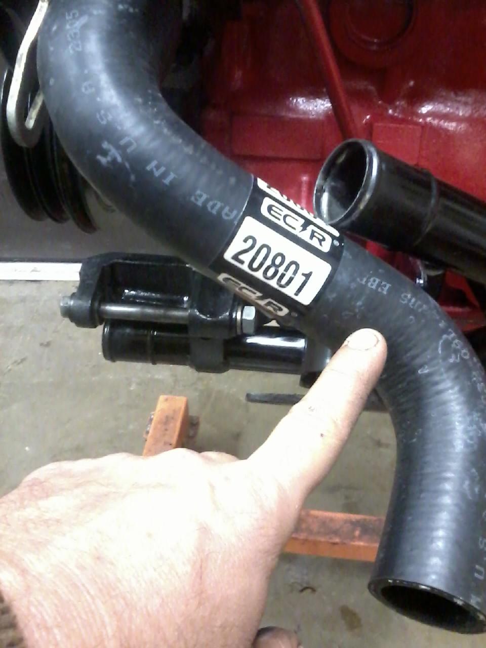

Except for the radiator hoses and the "U" shaped hose I have to get mine from a Toyota parts dealer. As far as the metal trim most likely need to get that at a boneyard. As far as learning the 22re, I try to put some information in my build threads and have links on the first page that I try to show how to do things.
I use Gates Rubber hose PN# 20801, around $10. It comes is a "S" shaped form, but when you cut the lower part off, it looks identical to the orginal and has the larger opening coming off of the water pump and the smaller end for the horseshoe pipe.
Gates PN#20801, just cut off where my finger is at. Alot cheaper then the dealer.
Attachment 114700
