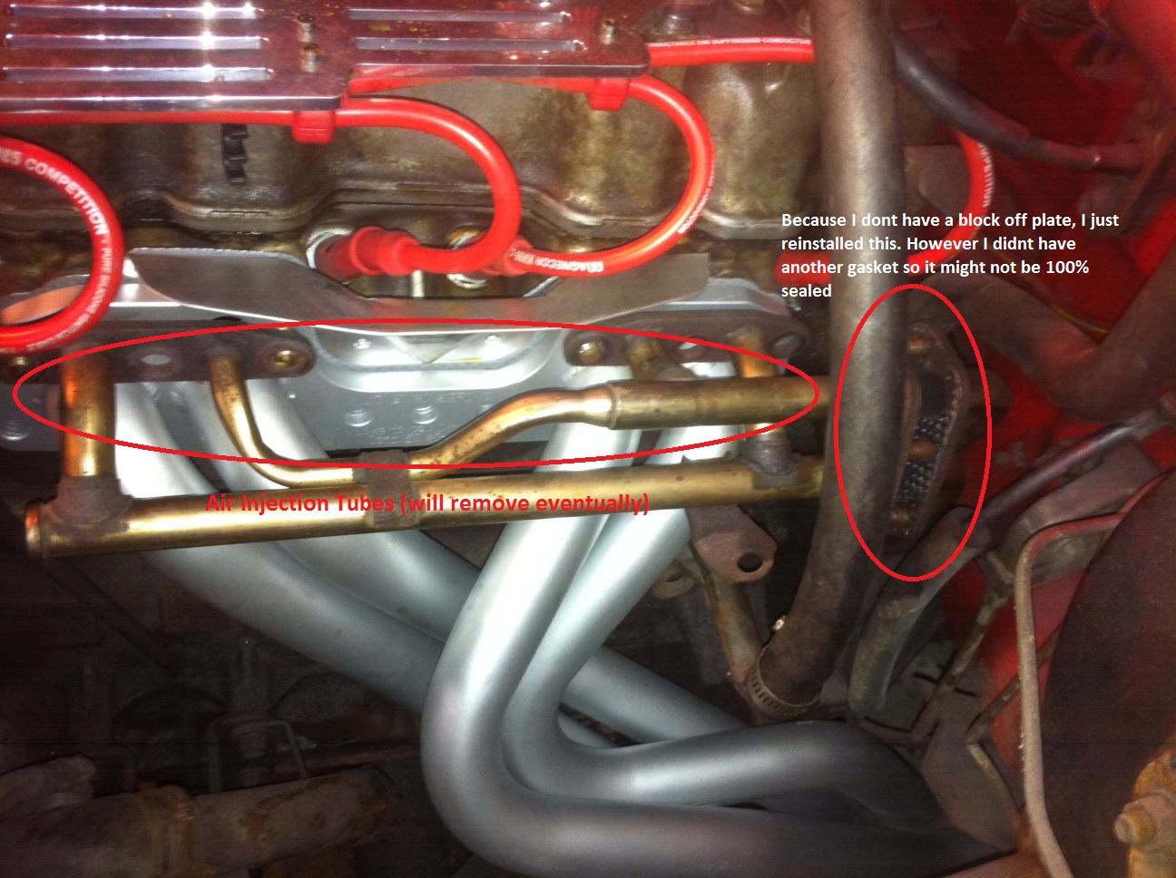

I also didnt have the block off plates for the air injection tube, I have the block off plates that go on the exhaust manifold to plug those holes, but not to go on the actual tubing that wraps around the back, so I just went ahead and installed the air injection tubing back on with the new headers, however I don't know how well the seal is. You can see this on the picture.
