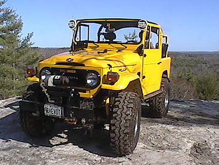

Also, I need to be able to keep up with my brother-in-law's '75 FJ, EFI 350 V8:

His FJ is mostly power and not much flex, does great in the mud, but no lockers. I can borrow his 36's anytime though!
