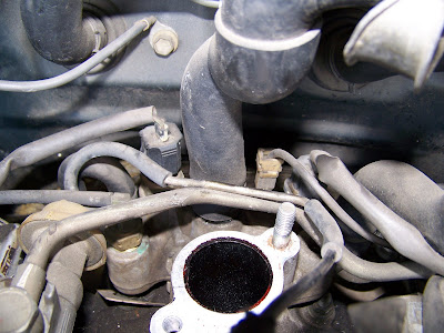

Here's a picture of the water distribution block (with the intake+plenum removed)

that is an excellent picture and I had no idea that was called a distribution block when I went to buy a gasket for it. but anyway I had the same problem after rebuilding my 3.0 and I had had to replace the gasket and re tighten down all the hoses on that litte block before it finally stoped leaking. another thing I missed is the liitle hose under the throttle body that coolant leaked through that eventually ran out towards the back of the engine.

o thanks for the picture, thats exactly what i thought it was, im not sure if it was coming from there but it was pretty close, i just took the plenum off right now so now i am gunna b able to get a better look at it, is there supposed to be a gasket over the hole? cuz if so then i never did put a gasket on it

i found the problem...it was the distribution block,i didnt know there was a big hole under it and i never tighened those nuts....thanks guys

does anyone know what this thing is,, its the one with the blue thing on it and the other blue thing broke off

That pic is very tiny, hard to tell, but looks like one of the sensors in the distribution block?
