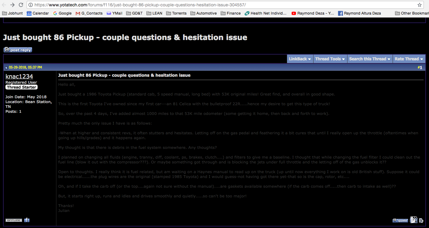

Hello all,
Just bought a 1986 Toyota Pickup (standard cab, 5 speed manual, long bed) with 53K original miles! Great find, and overall in good shape.
This is the first Toyota I've owned since my first car---an 81 Celica with the bulletproof 22R.....hence my desire to get this type of truck!
So, over the past 4 days, I've added almost 1000 miles to that 53K mile odometer (some getting it home, then back and forth to work).
Pretty much the only issue I have is as follows:
-When at higher and consistent revs, it often stutters and hesitates. Letting off on the gas pedal and feathering it a bit cures that until I really open up the throttle (oftentimes when going up hills/grades) and it happens again.
My thought is that there is debris in the fuel system somewhere. Any thoughts?
I planned on changing all fluids (engine, tranny, diff, coolant, ps, brakes, clutch....) and filters to give me a baseline. I thought that while changing the fuel filter I could clean out the fuel line (blow it out with the compressor???). Or maybe something got through and is blocking the jets under full throttle and the letting off of the gas unblocks it??
Open to thoughts. I really think it is fuel related, but am waiting on a Haynes manual to read up on the truck (up until now everything I work on is old British stuff). Suppose it could be electrical......the plug wires are the original (stamped 1985 Toyota) and I would guess-not having got there yet-that so is the cap, rotor, etc....
Oh, and if I take the carb off (or the top....again not sure without the manual)…..are gaskets available somewhere (if the carb comes off.....then carb to intake as well)??
But, it starts right up, runs and idles and drives smoothly and quietly.....so can't be too major!
Thanks!
Julian

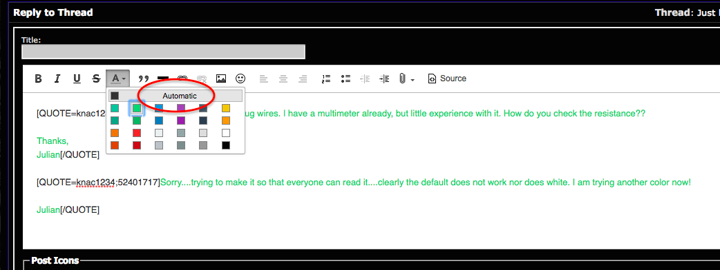

Nah, color did not change. I had to "quote" you and remove the color html's

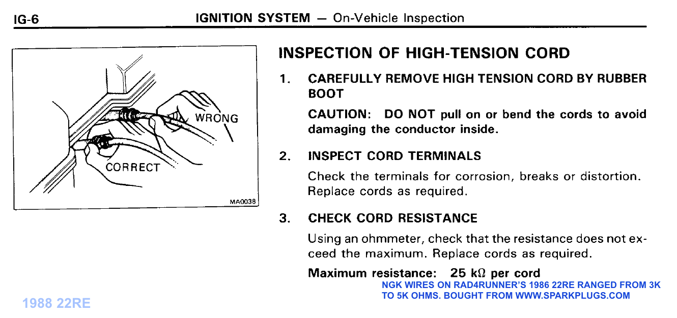

Definitely start with the simplest, lowest cost, easiest to do and obvious items like 33-YO ignition wires, and the othe usual maintenance stuff. Get a multi-meter (see signature) and measure resistance of the ignition wires.

Good idea with the plug wires. I have a multimeter already, but little experience with it. How do you check the resistance??

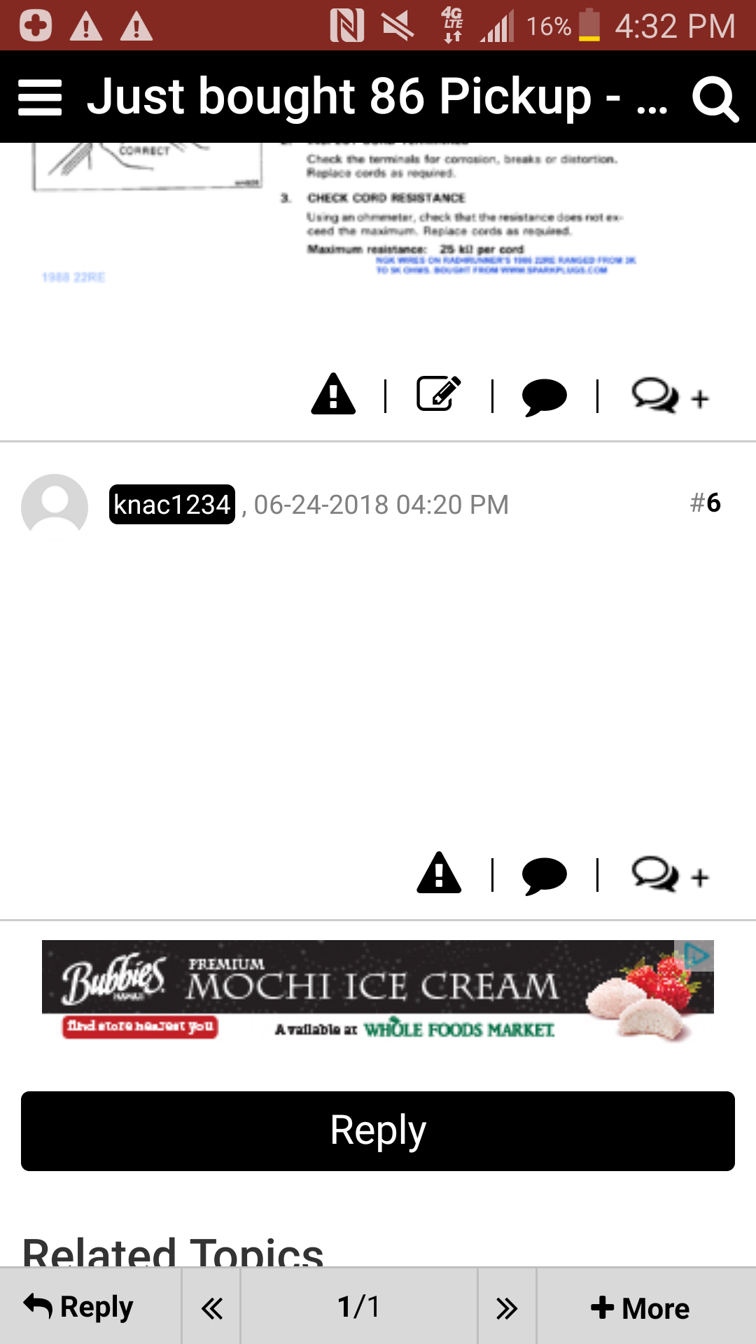

Still can't read what you posted.
This is what it looks on my Android phone.
I think you "colored" your text WHITE. Stop doing that. Displays with white background like smartphones will not show anything.

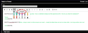

Sorry....trying to make it so that everyone can read it....clearly the default does not work nor does white. I am trying another color now!

Usually, "automatic" font color is safer to use.
Easy to check resistance, Please post clear picture (in lieu of a thousand words) of your multi-meter so we can show you how.
