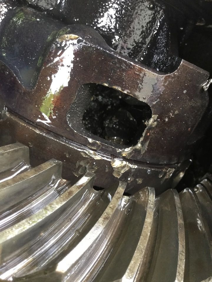

so I finally got to wrenching on the rig today..bought me an '89 V6 as a parts truck mostly for the rear differential.
I took out the old one and I didn't know I was running a welded diff. I'm no expert but I think they did a pretty
$#!++y job, well because the weld failed and there are weld splatters? everywhere.
The side gears were pretty chewed up. I'm wondering, could the little bits have caused the whole thing to fail?
Also, I had a hell of a time pulling on the passenger axle shaft (broke a slide hammer)
Check the pics:
Can't really tell but the teeth were all busted up inside:
Well, back to work, I need to get my rig going, the lava's coming!

Chunks of steel from any source certainly can trash a diff.
Even the welding itself can pit the bearings if not careful with the grounding.
Hope you're not really close to that lava....
