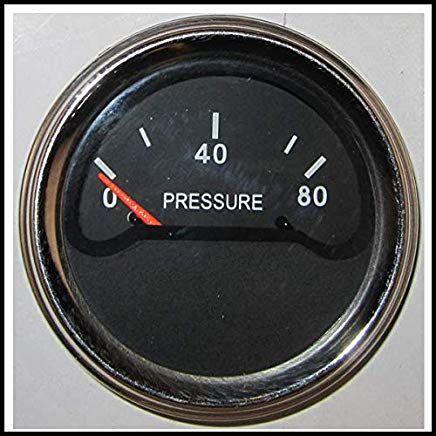

If you're talking about a gauge that looks like this:
The spec 4.3 psi will only be one needle-width above zero. So you won't be much better off than with the factory gauge.
And if you think the boys at Lowes look at you funny when you ask for a J.I.S. M10-1.25x15 flange bolt, try asking for a BSPT threaded adapter!
True, buy you can run the engine up to 3000 rpm and verify the reading and see how it compares to the stock one. you may also be able to find one with more markings, this one (like mine) has a dash for 20 psi, then shows 40, another dash for 60, then 80, no it won't be exact.
