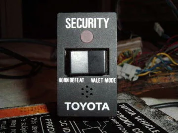

Hi, I need your help, I have a factory security in my 93 4runner, but i dont have a key fob, and dont know which one works with my system... my security ecu is under the driver seat, and looks like this:, on the dash i have a switch like this...
The sistem is working fine in both modes, only thing missing is a key fob...
Does any of you have this security ecu?

  #64
pperry71's Avatar
Joined: Aug 2011
Posts: 49
From: Auburn Hills, MI
same setup i have . i bought my FOB here - http://api.viglink.com/api/click?for...13519714387654
