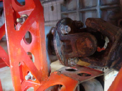

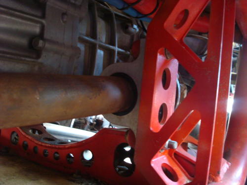

I've been running it for about 3 years(in a buggy) You don't have to turn down anything...Take your existing carrier bearing and tear it apart..remove everything until you get just a bare sealed bearing...That bearing should be a light press fit into the carrier..install snap ring..slide shaft through the bearing...bolt on flange..attatch to mount you have made...peal out
If you need more info let me know..I have one here I can strip dow to get ready for instal
Attached Thumbnails Hendrix Motorsports Carrier Bearing Support-dsc01628-2-.jpg   Hendrix Motorsports Carrier Bearing Support-dsc01627-2-.jpg
