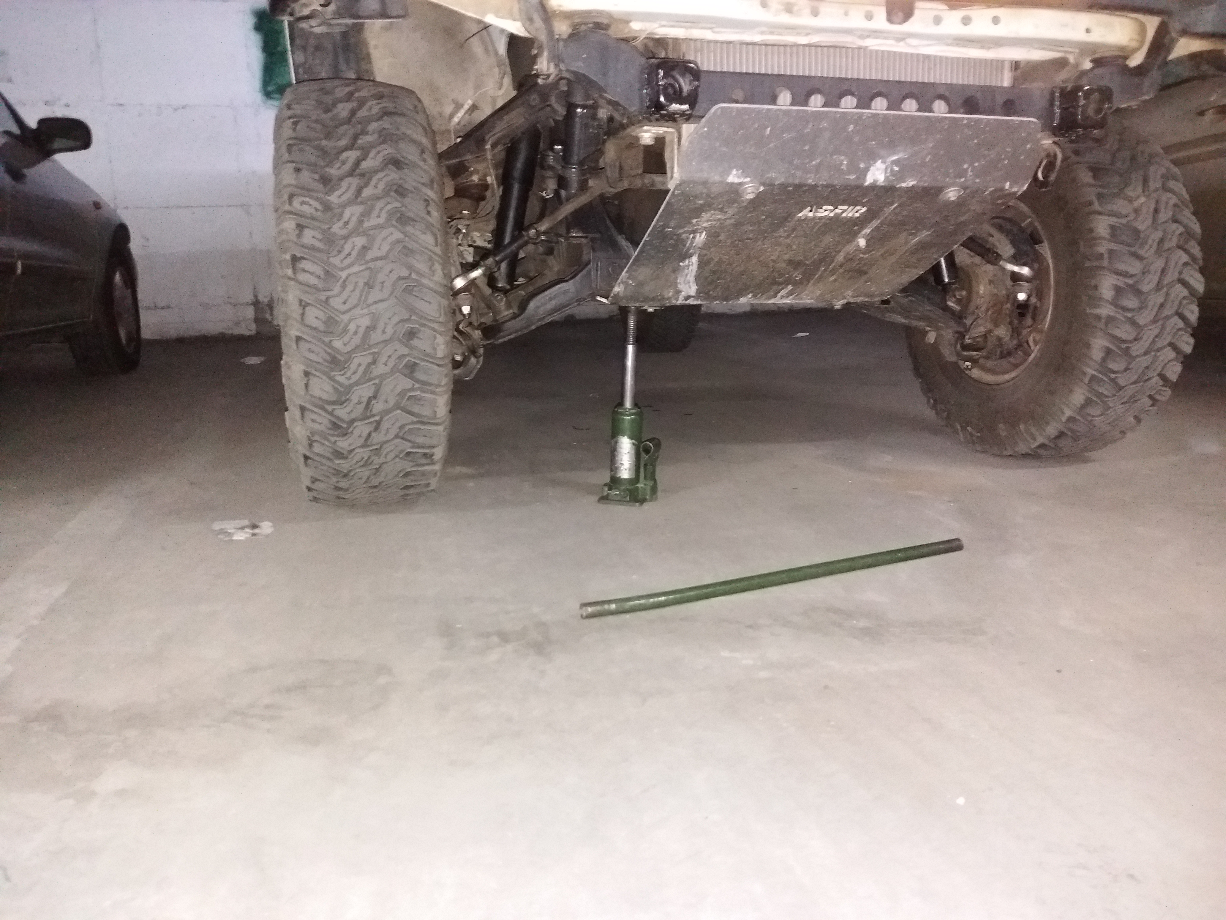

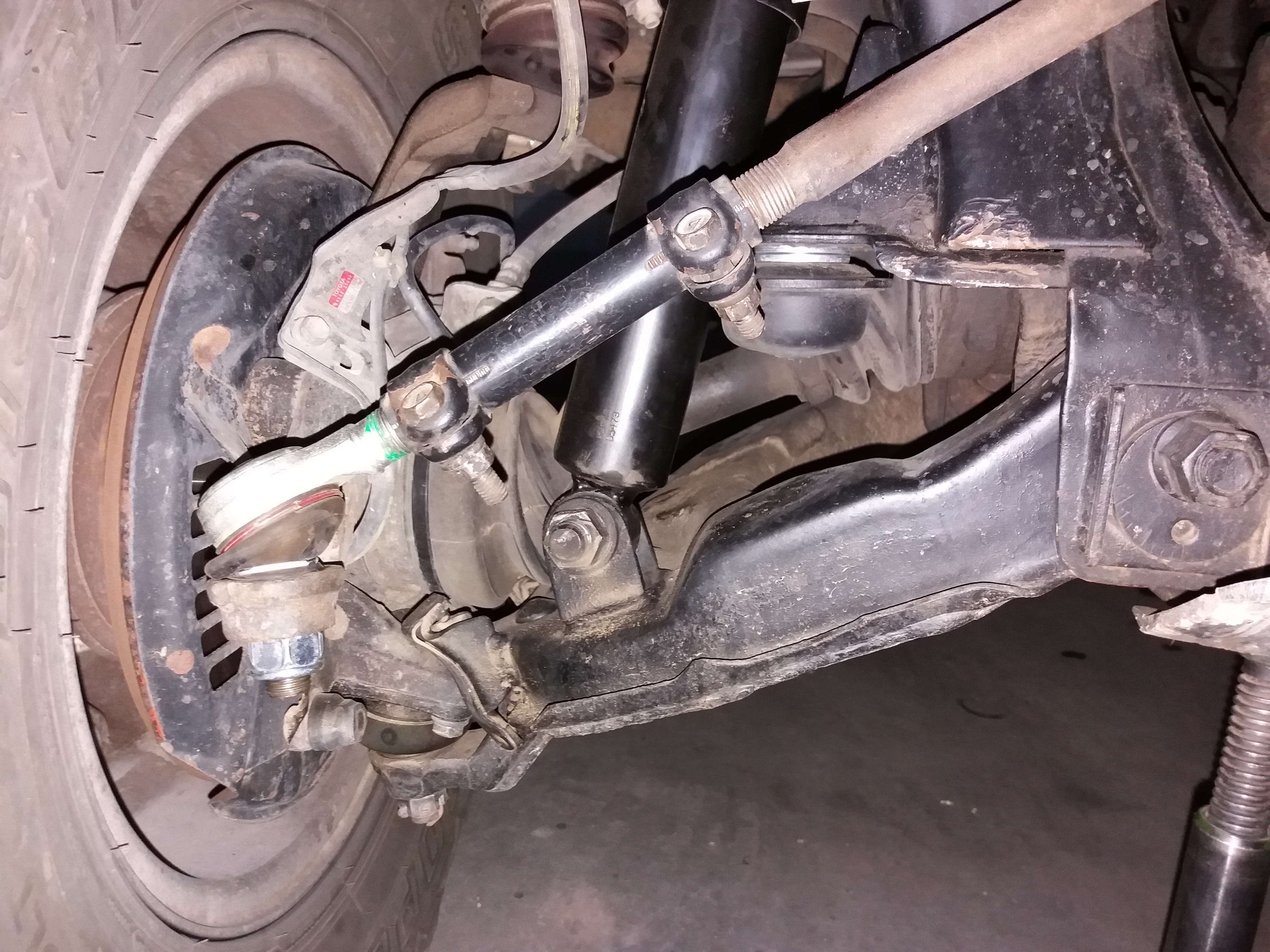

i can't find the item i need at all of the sites thats you just added
this is the reason
Dude Who put your front end together?
I think someone mounted the steering arms on the bottom, they are supposed to be on top. i could be totally wrong but your front end doesn't look right to me. did you crank your torsion bars or something?

again I could be totally off on your IFS, but even with a steep angle it doesn't look right to me

IdoHilux,
Total Chaos has a tapered insert that allows you to use a straight bolt. It reduces the ball stud shaft to a 1/2" straight bolt. To counteract the reduction diameter and in strength you need to weld on an additional bracket to the steering arm. This configures the steering arm to double shear. I doubt you will be able to obtain this adapter unless you by the complete bolt kit and steering system upgrade? The next option is to have a machinist turn a "heim Extension Pin" to fit into the taper of the steering arm. Another option is to ream out the steering arm to a taper of a larger rod end, say an FJ-80 or Chevy or something bigger and beefier. Lastly, you can hog out the taper to a straight bolt, of say 5/8" but this large diameter bolt may limit the angle to hi-mis spacer and to the joint. If you search here on YT you can find a post I wrote about these steering complications.
