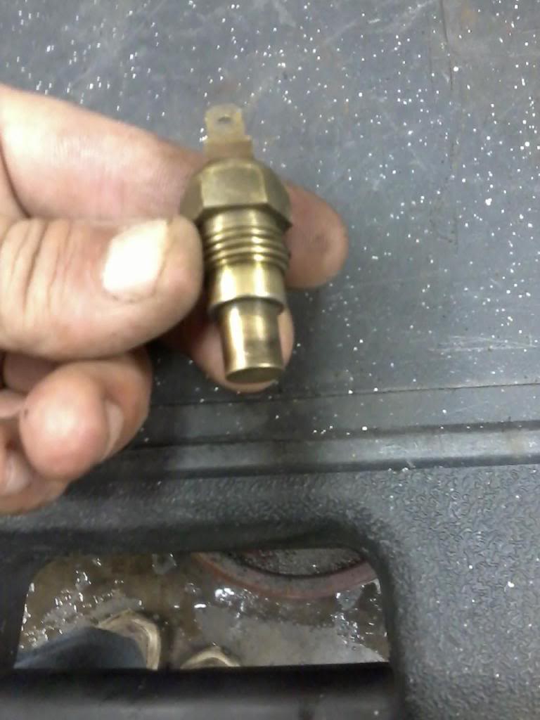

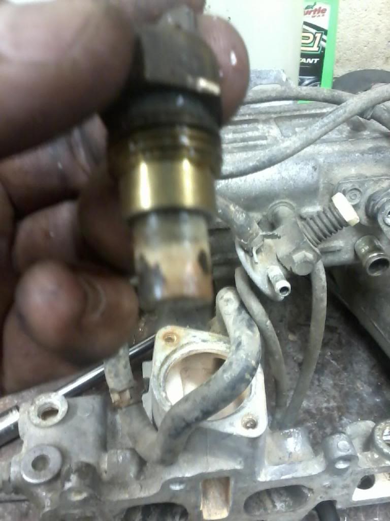

A while back I was mentioning that my wifes truck water temp guage was going from half way to cold. I actually forgot about it until I drove it today and it did it again. I pulled the water temp sensor and it had green corrosion on the sensor cleaned them with a brass wire brush and then I cleaned the contacts that goes to the wire as well with electrical contact cleaner. No more problems. Stays just below half as it usually does. I knew it wasnt overheating, but still like having a guage.
Here is a picture of a dirty Temperture Sensor. I have seen worse. I chipped some of the scale build up off so you could see a difference.
The sensor sits just below the Cold Start Injector in the Intake manifold. Uses a 17mm deepwell socket and is a 5 minute job.

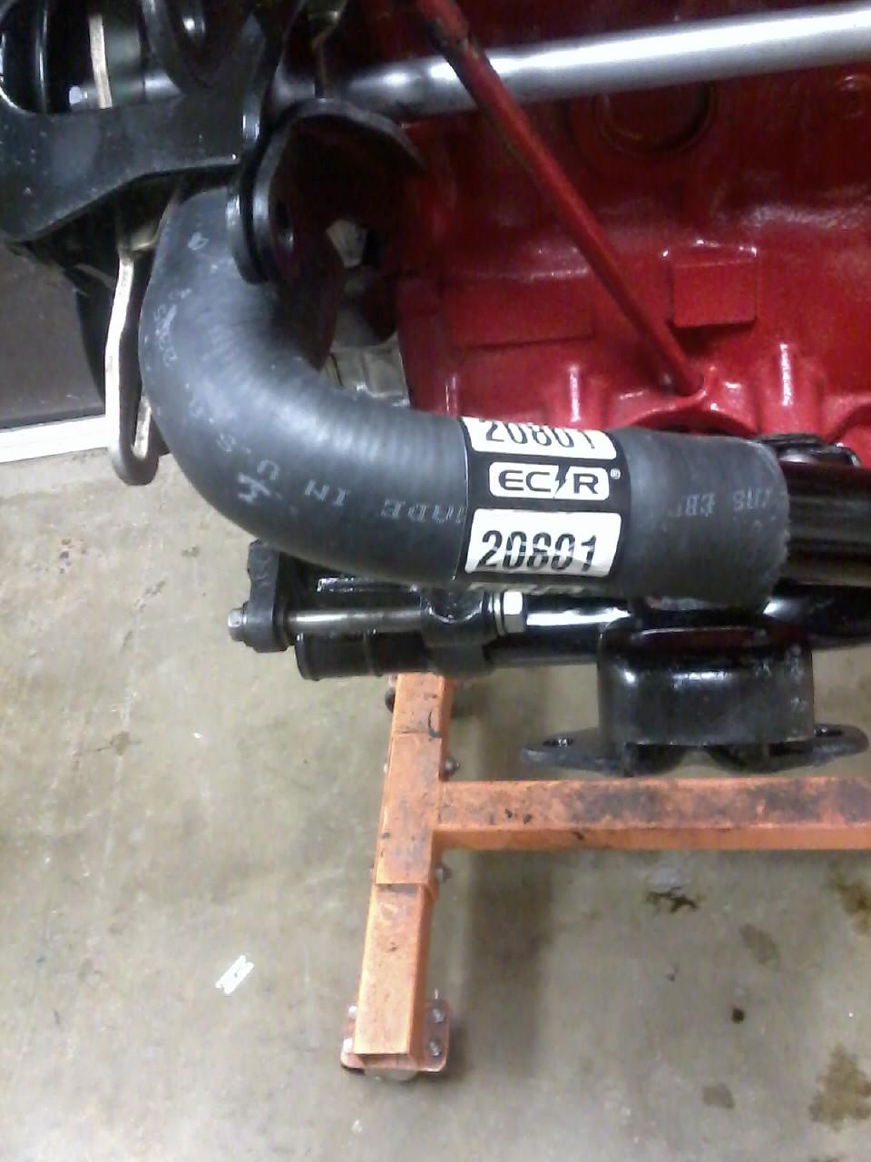

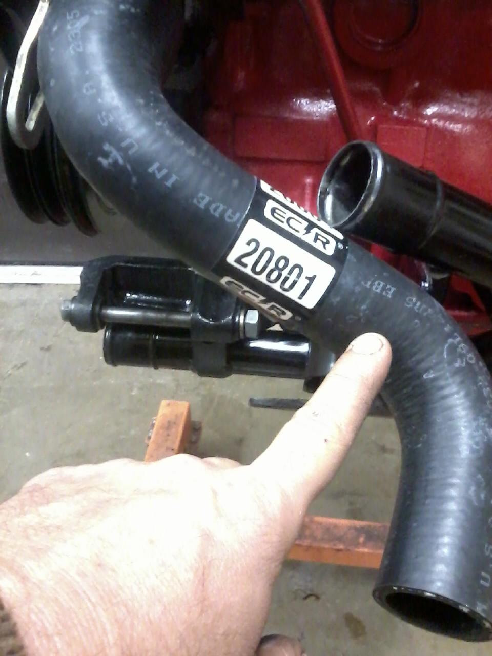

I use Gates Rubber hose PN# 20801, around $10. It comes is a "S" shaped form, but when you cut the lower part off, it looks identical to the orginal and has the larger opening coming off of the water pump and the smaller end for the horseshoe pipe.
Gates PN#20801, just cut off where my finger is at. Alot cheaper then the dealer.
Here it is cut to length and on. I need to get some new hose clamps to finish the job.
