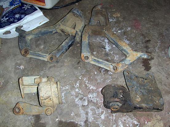

okay, let's start with the last pic:
top left- right front suspension knuckle extension
top right- left front suspension knuckle extension
bottom are transmission drop brackets and bushings- IIRC, the one on the left is on the right side of the vehicle and the one on the right goes on the left.

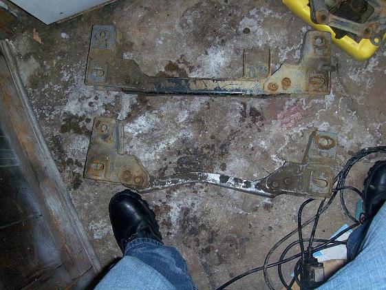

2nd pic-
Top is the front drops and differential mount
bottom is the rear drops and cross brace. that cross brace needs replaced before you even think about installing the kit.

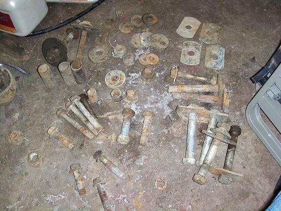

1st pic-
That's all the hardware that bolts the front end together.
Like I said above, looks like you got a take-off. No wonder there's no instructions.

is the cross brace salavagible if i press it straight, and my be welded some plateing or a gusset
I wouldn't try. It hit something pretty hard and would likely fracture trying to straighten it. I'm trying to figure out how it got bent and not the front...
