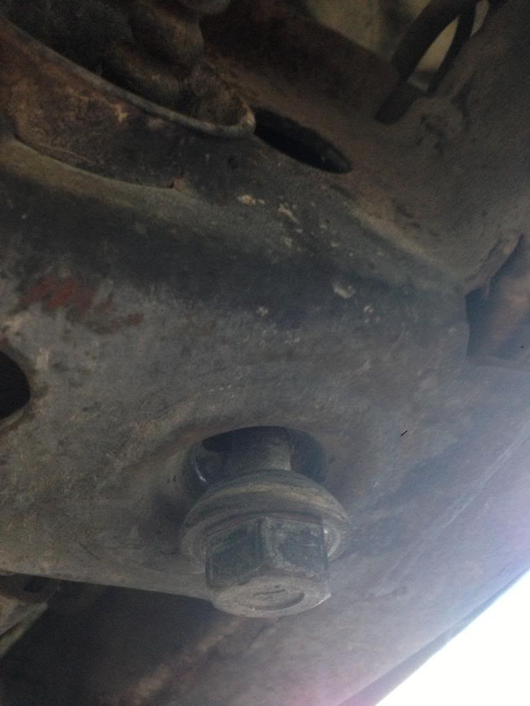

SO I got to looking around and it looks like the big bolt at the rear of the bar backed out and the bar popped out losing tension. Does that sound right, like I said I dunno how the bars work. What is the best way to put the bar back to tension and tighten that right. Is there anything else I should check?

Yeah I'd say that would do it.
I would try to just putting a wrench it and tightening it up. It should tension up.
