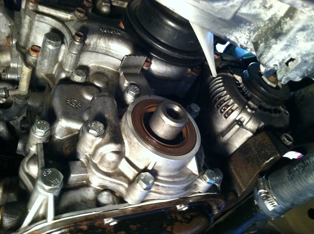

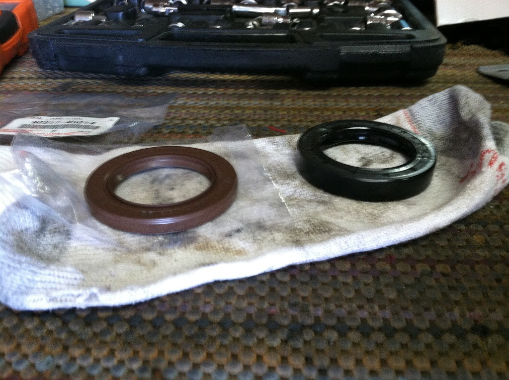

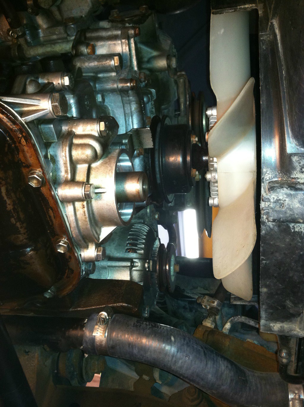

I have read every thread on here tagged with "oil pump" and "front main seal" and there seems to be some confusion as to whether or not the radiator, fan, belts, etc need to be removed to gain access to the front main seal.
I just replaced the main seal without removing any of those things, no problem at all.
I should've replaced the oil pump o-ring at the same time, after I finished I noticed some oozing from around the oil pump housing.
Just thought I'd squash the confusion, here is proof:

Nice contortionist act The usual reason to pull that other stuff is to get a pully remover in there. Did you use one, if so what style?

I didn't have to use a puller, I gave it a little tug and it just about flew off.
The crank pulley bolt was a non issue either, I used a really long breaker bar.

I replace front main seals in the truck on 22r's and 22re's all the time WITHOUT removing the radiator, fan, belts, etc. I can do it in under 30 min. I bought a seal puller from harbor freight. I cut out about 2" from the HF puller and welded it back together. There is just enough room from the bottom to lightly tap the handle on the puller to make the seal pop out. I also put a thin piece of wood to cover the radiator just in case I miss the puller with the hammer. I also fabbed up a little round "cup" that is the inside diameter of the seal. I use the crank bolt and the little cup to get the new seal in. I just lightly tighten the crankbolt that goes through the little cup and the seal slowly snugs down on. I do this because it is very hard to get an even seat and seal on the main seal as it goes in. There is no room to tap it in. The little cup method works flawlessly.
To torque the crankbolt I put the rig in gear apply the breaks or remove the valve cover to inhibit the crank from turning. Torque to 115 ftlbs.
Never had one problem doing this method. I have done hundreds of them. It beats tearing apart the entire front end.
