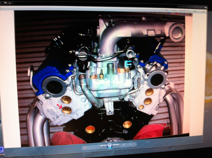

I have 1995 3vze 4wd 4runner
I found a leak in the lower freeze plug driver's side
Marked in the picture attached
This picture is not my engine!
is taken from the site just for show where the problem is
Any idea how to fix this problem without having to remove motor out?

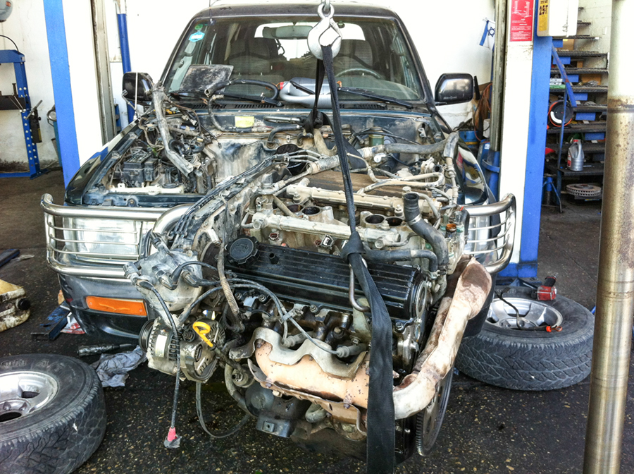

Anyway, I decided to get out the engine
Because I want to replace all the freeze plugs on it
And at the same time to replace the gasket between the gearbox and the engine i have leaked there..

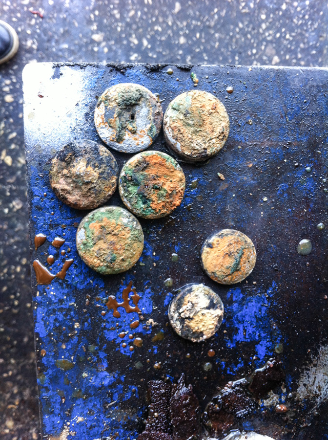

Thanks Here are some pictures
The decision to remove engine out and it turned out like the right thing to do
I found another leaking freeze plug behind the motor between the transmission and the engine
Others also seem like they going soon finish their life
I also found a leak in the metal tube that sits under the manifold

Consider "pressure testing" the heads, and if there is a way to do it, the block. (I've only heard of it being done on heads). Those freeze plugs are quite rusted, so you might wonder if you have small holes elsewhere in the cooling system. It would be a shame to replace all the freeze plugs (and leaky coolant lines) only to learn you have a small hole in the block itself.
