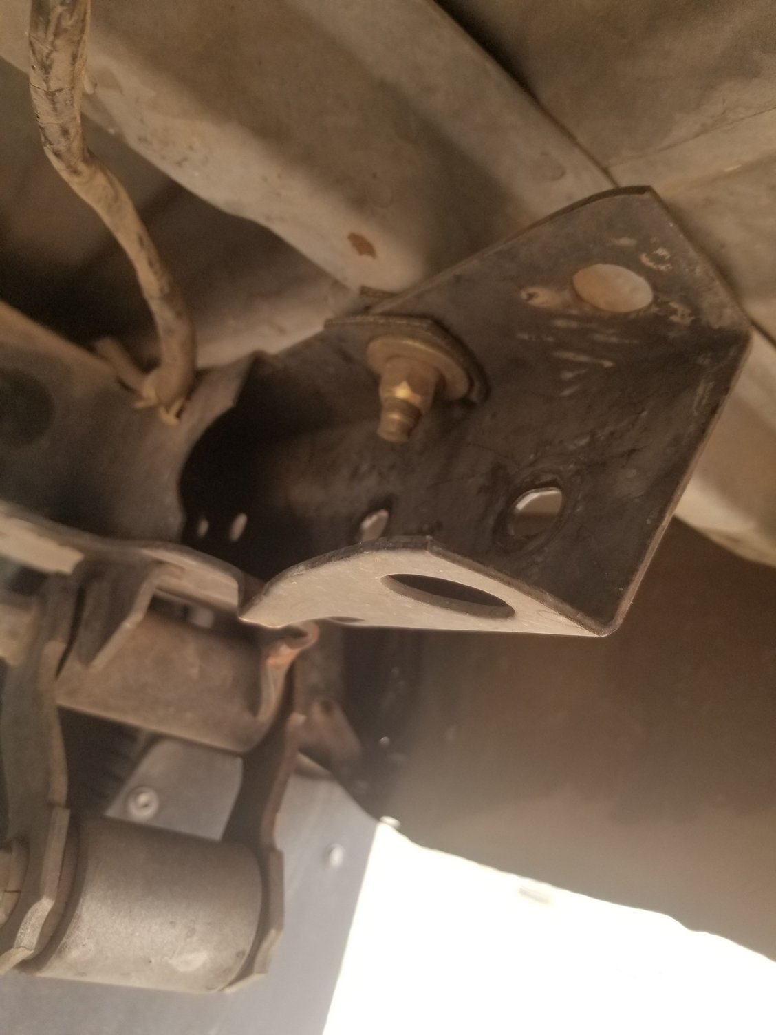

When I got this truck it had a lot of vibration. I drove it home about 120 miles. Noticed the driveshaft was dented...
I replaced the driveshaft with another from the junkyard. New U joints and it was balanced.
A lot less vibration now but still above 60 mph intermittently.
I'm going to get the tires balanced and change the tie rods, centerlink, swaybar bushings and end links before I take it for an alignment.
Really hope this frame damage isn't the cause of the vibration. Or maybe driving with the dented driveshaft caused some issues as well. I have no idea how many miles were put on it with the dented driveshaft.
Right rear
Probably why there was no rear bumper
Would an alignment shop be able to tell me if my frame is not straight? Obviously it is messed up but looks to only be the very end that is bent.

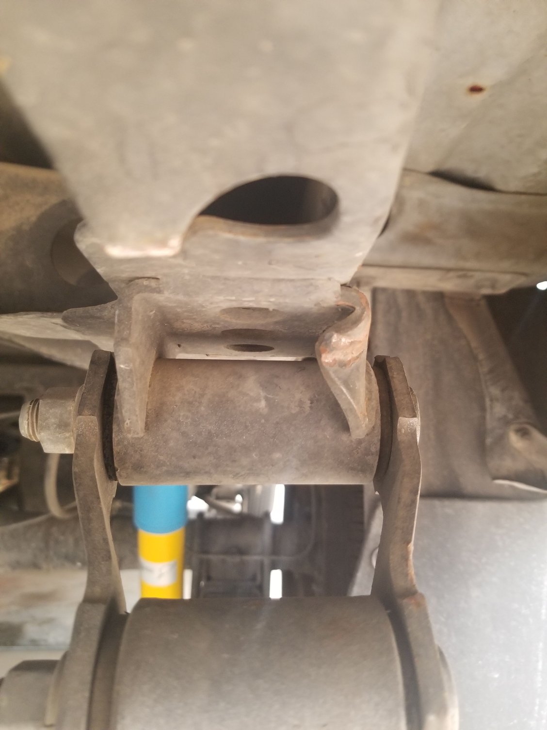

Here is a pic of the left rear for comparison. Looks like the truck might of side swiped something and clipped the bumper on the right rear. Just a guess.

You can call around and find somewhere that can put your frame on a machine.
Diy solution, you could get some squares on the good side and figure out good reference points to measure on both sides and compare.
The main issue is if your leaf hanger bracket is cocked, its putting a twisting stress on your axle so youre truck wont be track right.

it didn't sideswipe something; somebody wrapped a chain around the frame/shackle mount and pulled, hard. or got pulled out of a "stuck" hard.

Truck was probably lightly rear-ended at some point. An alignment shop can tell you if the wheels are still where they need to be. You'd need an auto-body shop with a frame machine to fix it. You can also make things better yourself, if necessary. Just need to get creative with winches, trees, bottle jacks, big pry bars and big hammers.

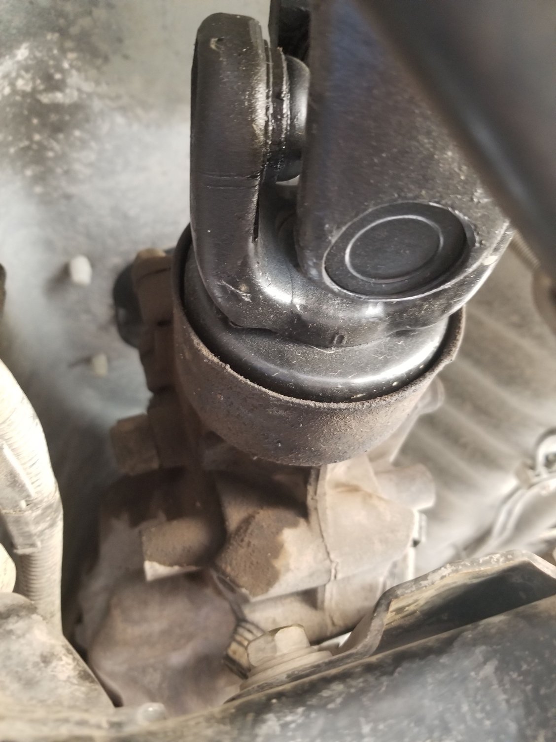

Make sure the slip yoke is still tight in the back of the transmission. An out of balance driveshaft could have wore something there causing it to wobble some. Also check that the rims are still straight with a dial indicator. Something had to hit the driveshaft hard enough to bend it, and being 2wd it was not slow crawling. I would think it took a hit going off the road or something which could have bent a rim. You can also jack up one wheel at a time, spin them while watching carefully to make sure nothing else is out of round. Another thing to check is the transmission mount.

Not sure how much the driveshaft should move. I went under there and it rotates about an 1/8 of an inch. The slip yoke seems tight. No sounds from third member when spinning rear tires.

Slip yoke

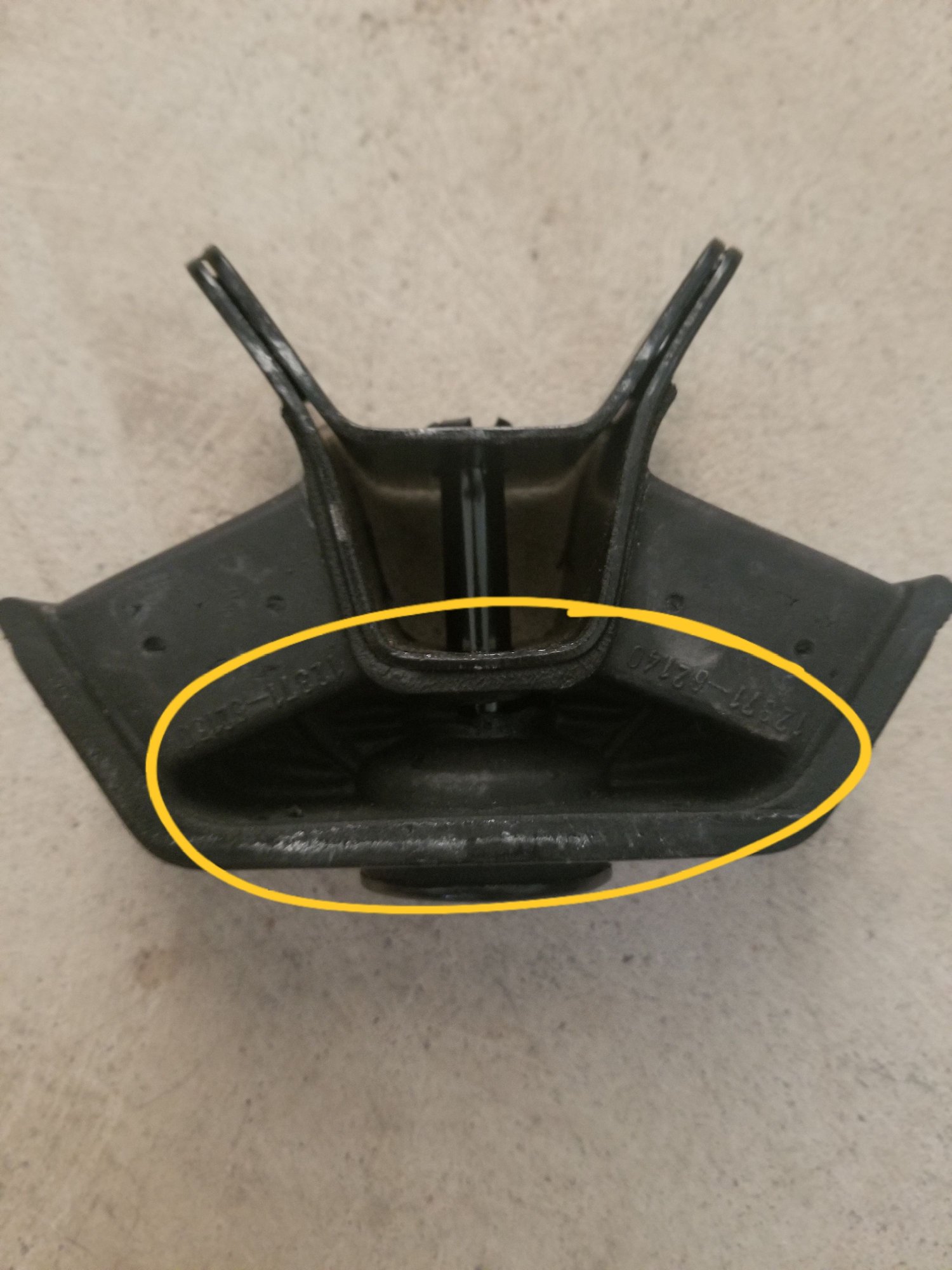

I not sure tightening that bolt will help. I purchased a new mount from NAPA and the center bolt is a post.....no threads. When putting weight on the mount it will naturally push the center post out.
Maybe the OEM mount has softened up and compressed over time and I am unable to snug up that center bolt while the mount is being compressed by the transmission. Does anyone else have this exact mount (OEM) and the center bolt is snug? I have the W55 transmission. 2wd manual.
This is the mount from NAPA. It has a post for the center bolt instead of threads. When this mount is compressed, the center post extends out. The area I circled is where the rubber gets pushed down as seen on the OEM mount on my truck.

J94: Now that I am looking at it closer, the picture of your old mount looks like the bolt was torn away from the rubber piece on the bottom, yet the bolt looks like it cannot be any tighter up top. Post a pic of that new mount when it is installed. I am curious to see how far that pin moves, if at all.
