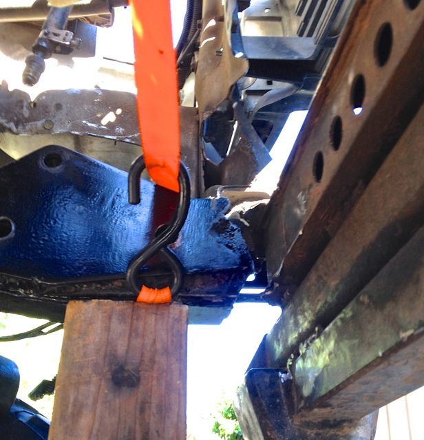

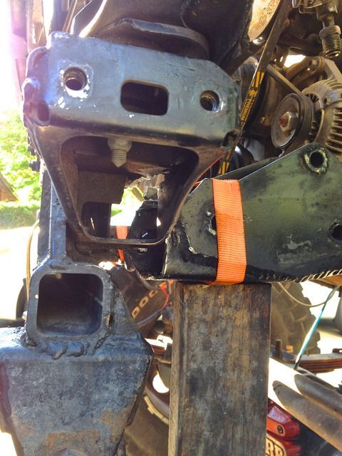

The front driver side frame rail cracked and separated from the front crossmember . I'm not sure of the cause , but my 90 4runner is a big rock crawler , so I abuse it pretty good , but the fact that the frame itself fatigued and cracked was pretty surprising . My plan is to fab some custom L-brackets and hit all four sides of the frame to the crossmember , with additional gussets going diagonally to reinforce .
Anyway , this is a big project for me , and I'm considering just taking it to local 4x4 shop to have them do it ....

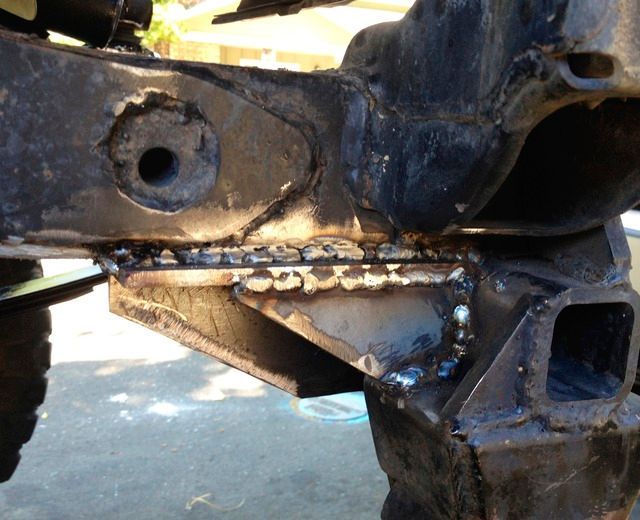

The repair is going well , just slow . I'm getting married in 8 days so not a lot of truck time available . But I got the frame rail and crossmember back together . I've also added lower gussets on both driver and passenger side , and I only need to add diagonal gussets between the rail and crossmember to combat steering box related torque and fatigue...

top plate
https://cimg1.ibsrv.net/gimg/www.yot...4b897d5651.jpg
there's actually a gusset on the other side that isn't shown
https://cimg5.ibsrv.net/gimg/www.yot...ea69a5e95d.jpg
passenger side
