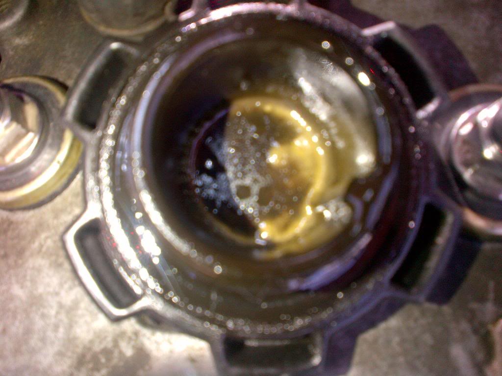

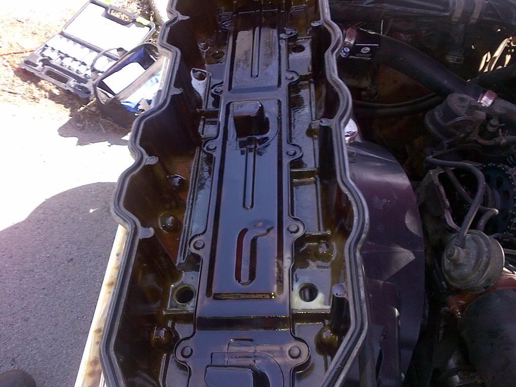

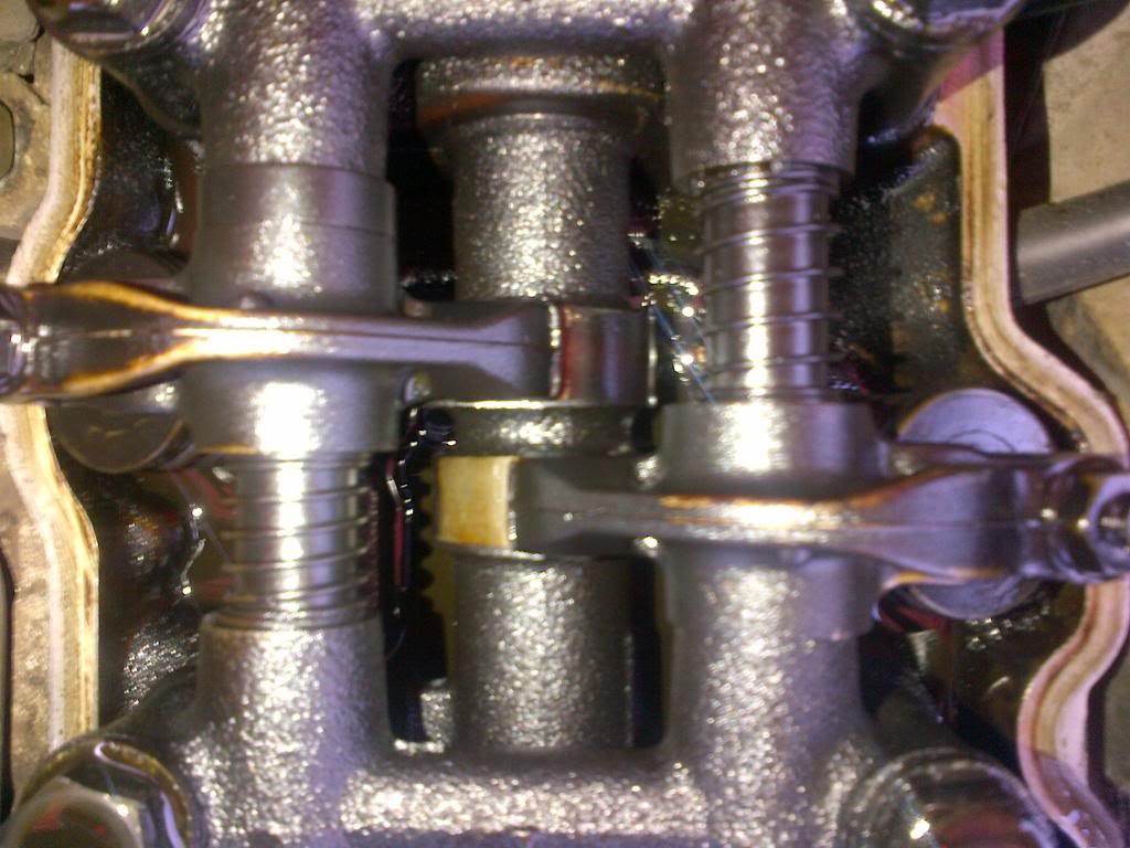

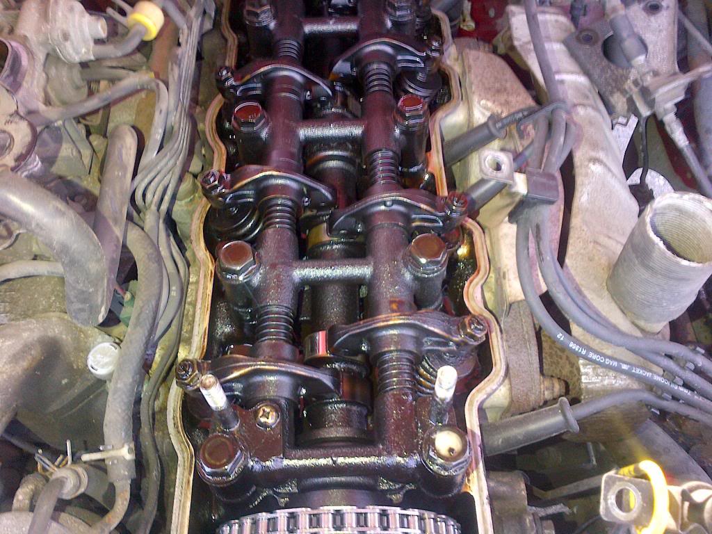

Pulled my VC this morning to make sure I had the correct torque on my distributor cam gear bolt (just did the timing chain job on her) and I found a bit of moisture in there. Nothing too alarming but definitely something to address.
Some pics :
Front driver's side head bolt there :
Under-side of valve cover with some moisture under where the two front grommets seal :
And a bit on the underside of the oil-fill cap :

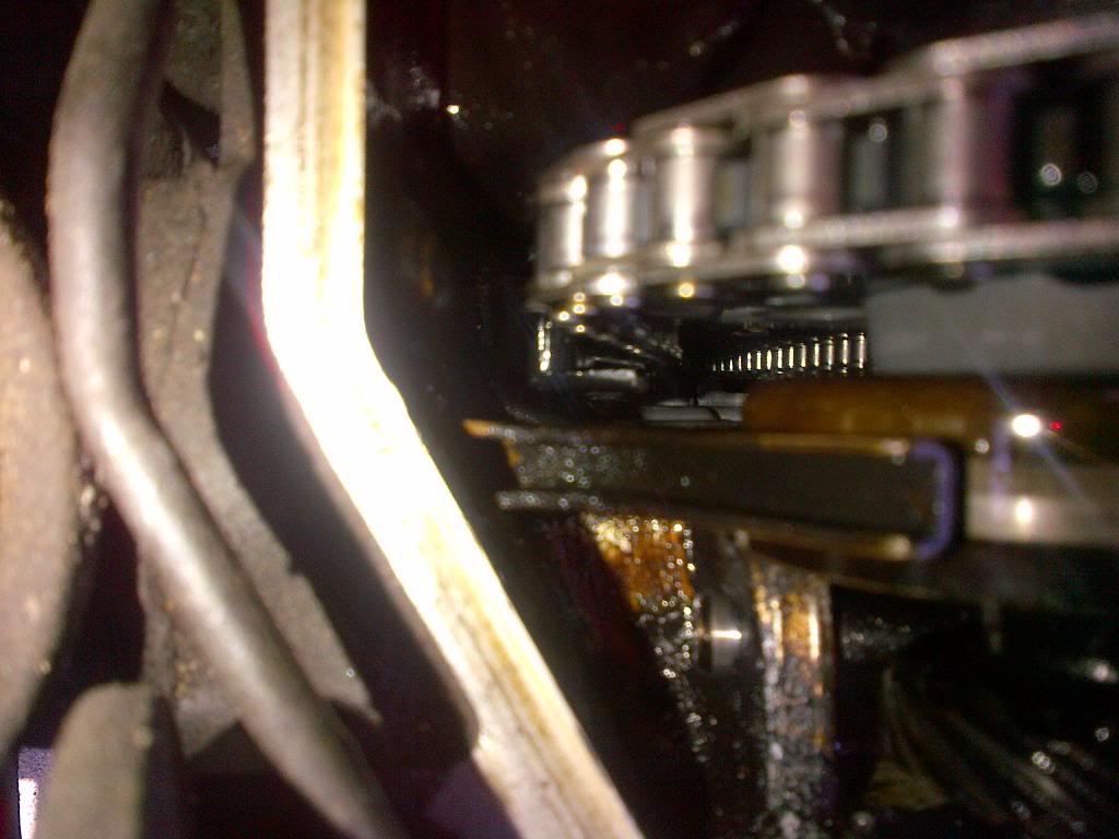

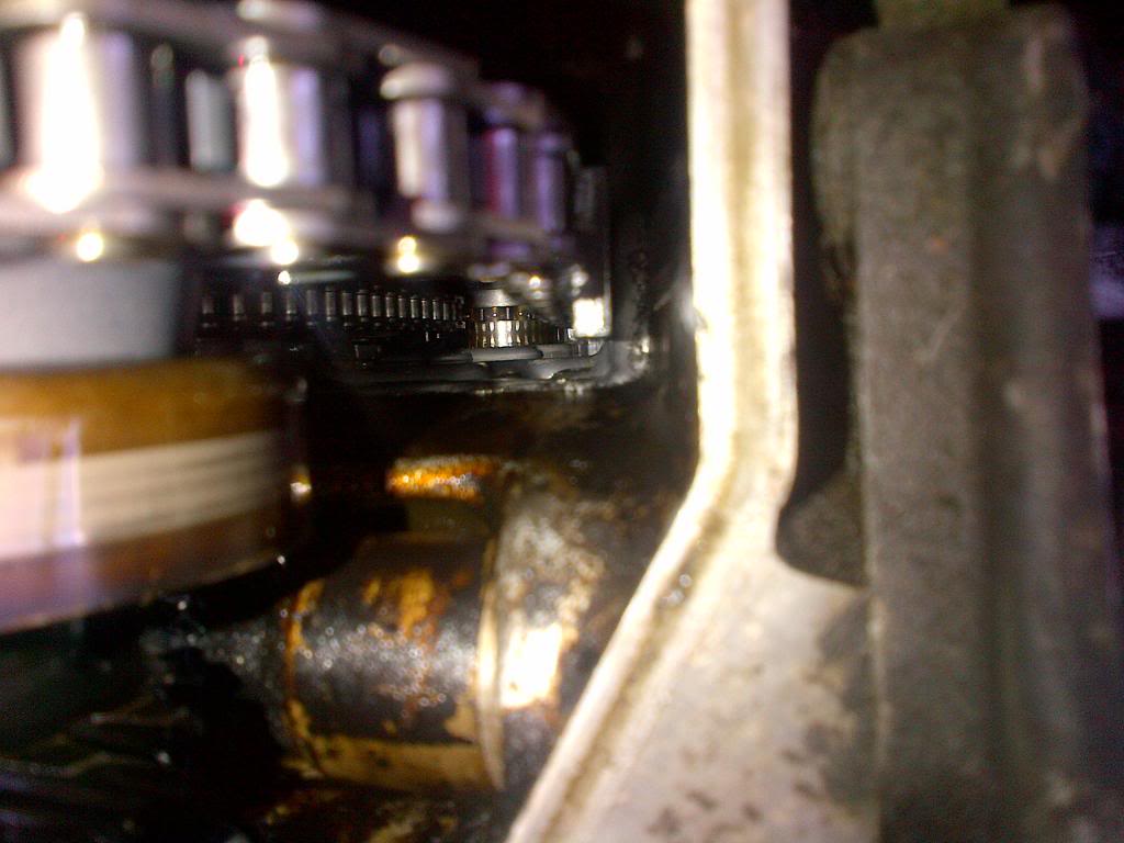

Some pics of inside the timing cover to see if there was any moisture there:
(Notice more moisture on the inner edge of the front half-moon plug.)
(Thought this was a really cool shot. )
All seems to be well inside the timing cover. I'm hoping to attribute the moisture to an under torqued valve cover since I didn't have the torque specs handy when I reinstalled it the last time. I just put it on tight enough to seat the gasket (or so I thought) and stopped.
I also have noticed that when I open the oil-fill cap after the truck has been running, there is some kind of gas coming out of it. (exhaust? Hopefully not steam! >.<) It seems like I've heard before that is normal and it's probably caused by a part of the emissions system?
Another thing I've begun to notice is that my oil is definitely getting contaminated with gasoline. There's no mistaking that smell under the valve cover and on the end of the dipstick. (Could be unrelated. Have yet to replace my fuel pump and I've read about the diaphragm leaking)

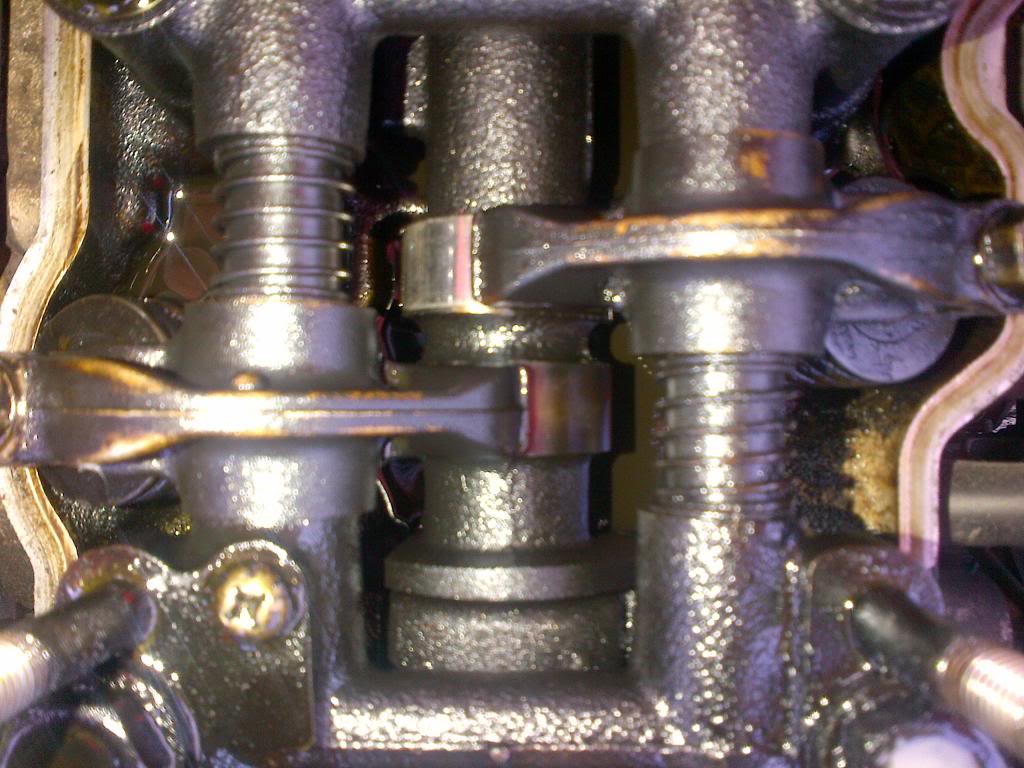

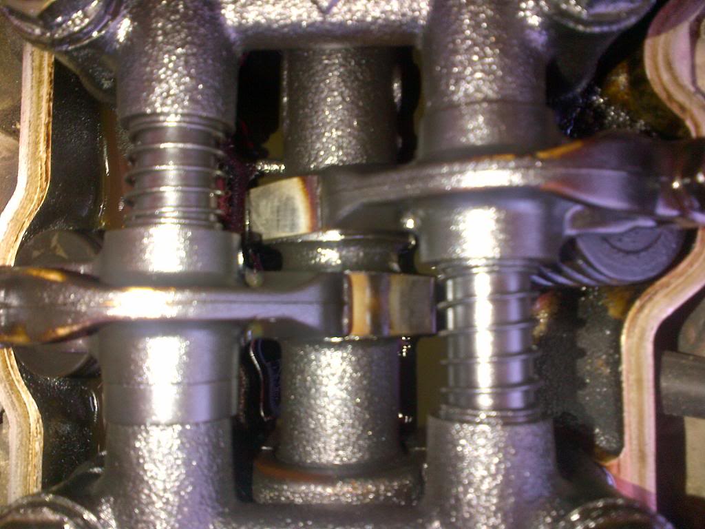

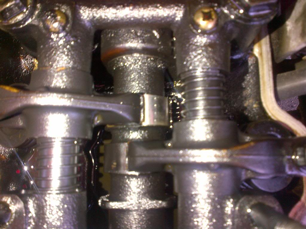

One last thing is that I noticed the lobes on my cam are not worn uniformly. Some are bright and shiny and polished, and others are very dirty and gunked up. Here are pics of what I'm talking about. :
Cylinder #1: Lobe for intake semi-dirty. Exhaust lobe nice and shiny.
Cylinder #2: Intake lobe dirty. Exhaust lobe semi-clean.
Cylinder #3: Intake lobe clean. Exhaust lobe clean.
Cylinder #4: Intake lobe bright and shiny. Exhaust lobe very dirty.
The reason I include this is that I'm wondering if any of these issues could be due to bad valves/valve seals/valve adjustment and if the inconsistent wear on the cam lobes could be evidence of any of those.
