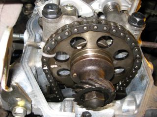

well, what I have done so far is rotate the crankshaft which "sort of" rotates the sprocket and chain. The zip tie is near 1 o clock so I can crank a quarter turn and bring it around 9 o clock at which point I can slip on the sprocket and if I want "tighten up the bolt" and then turn the crankshaft a quarter turn clockwise back to near TDC. Would this be bad? or fix my problem?

Well enough for tonight, my options end up being (1) keep the chain on the sprocket, rotate the crankshaft quarter turn counter clockwise, slip on camshaft and then rotate crankshaft quarter turn clockwise. Whether it is good or bad, I already have the sprocket on in this 8 o clock position so it would be easy. Alternative (2) is to pull it off and reposition to TDC, and loosen valve adjusters I guess to move camshaft. Option (3) might be to remove sprocket, go back to TDC, take head off and have it checked out by somebody for valve damage and then install w/ a new head gasket the right way. ... I'm tired.

Are there any lobes pushing on valves at 8 o clock? I have never seen anyone install a head with a load on the valves and I'm not sure if it's even possible? I think it would be quite noticeable while setting it down and torqueing. I'm thinking the valves would just push on the pistons and move the crank position a bit, unless the spark plugs were in? Just unbolt the cam sprocket, slide it off, rotate the cam and crank individually, and while you are doing it if there is any excessive resistance you'll know...Put them where they need to go and reinstall the cam sprocket. The cam sprocket takes just a bit of prying to get it back on the sprocket. Remove the spark plugs if you haven't already and it'll be that much easier.
