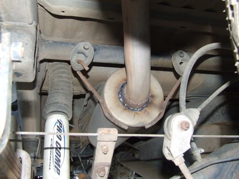

My Magnaflow Muffler actually has shook loose at both ends from bouncing off road, I guess. It only took 30,000 miles. So I asked my muffler shop to weld the pipe back up and weld a brace on. Even though I have a lifetime warranty with Magnaflow, it's almost not worth the trouble to try and get a new free one.
The rear, welded back up. It's shameful that a Magnaflow Muffler would separate like this!
