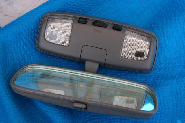

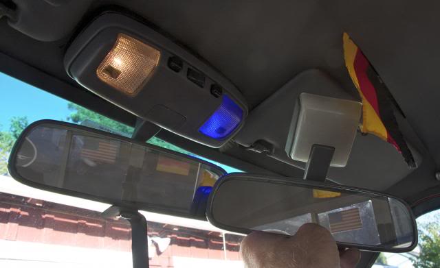

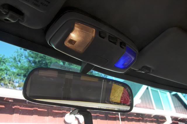

Dome light from a junk yard.Name:  2013-07-05150411_zps0b6bd988.jpg
How difficult was that swap? Was actually thinking of that exact swap, but also one that goes to the rear of the seat where the head meets

Originally Posted by 83Toyota88
I got a rear view mirror with auto dim/compass plus a overhead console from a 96 Suburban I put in my 1st gen. Still have to put a headliner on it though:
[IMG][/IMG]
put new fabric on it and painted it match my interior:
[IMG][/IMG]
[IMG][/IMG]
^how about this
