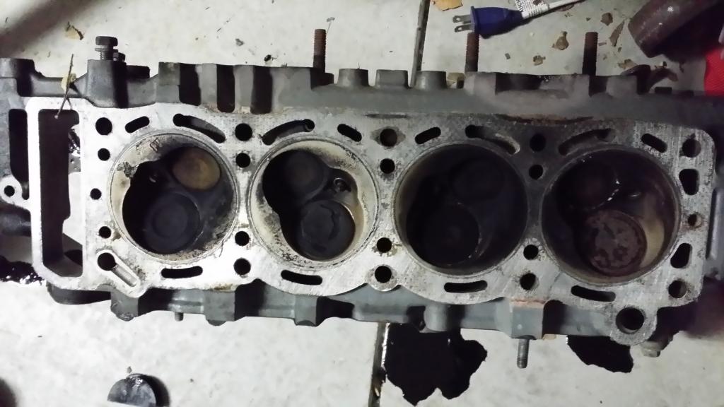

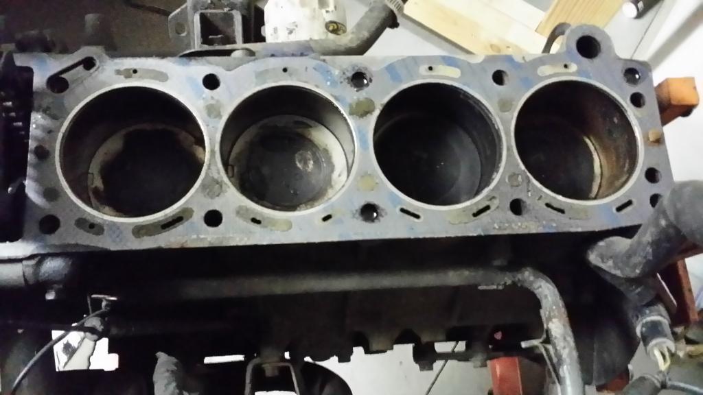

Bringing this back up again, almost a year later, because I've made a few decisions and would love to hear opinions.
A good friend of mine swapped the 22-re from an 88 4Runner (with dash, wiring, and more) and that left his "freshly" rebuilt engine free, which he gave to me. Since my block is toast, and there is likely to be crank damage (whether it's repairable won't be known until I actually pull it, right now it hasn't been touched and still sits in the engine bay, reasons follow), I went ahead and took the engine knowing it had slightly low compression on 3 cylinders, and 1 completely dead. I started tearing it down, and quickly found out why the cylinder was dead, and why it was running so rough for him:
It seems there were a few problems, the carb was dumping fuel like mad, there were 1 or more air leaks, and the block was never machined before he put it together. This all combined for the poor compression and allowed a large amount of carbon to build up under the #2 intake valve and prevent it from closing. This engine has about 2-3k miles since it was rebuilt, and I know the internals on my engine were much cleaner at 190k than this engine is. Having made it this far, but no further yet, I've decided to do the following:
1. Master overhaul kit from RockAuto, including pistons, wrist pins, bearings, oil pump, timing set, cam chain dampers and tensioner, plus gaskets and seals
2. I've found a couple of local shops that are supposed to do quality machine work so I will be having one do:
a. Hot tank block
b. Pull freeze plugs
c. Polish crank
d. Inspect and clean rods, press new pistons
e. Bore twenty thousandths over and hone
f. Set ring gaps
g. Install threadcert in bad head bolt hole
3. Ordering a new casting loaded head with RV cam from Sunwest Automotive
4. New rockers and rocker shafts
My questions are, who has done overbore on these engines? Do they have any issues after boring (i.e. overheating)? My concern is I don't know how many miles are actually on this block, so by boring I should ensure the piston tolerances are as tight as factory.
I know some are running the Sunwest engine, but how many are running the version with the new casting head and RV cam? Any issues with it? Are there other shops with new casting heads that I should look at, or that you have experience with? I want a new casting to hopefully insure this engine last for many years.
Hopefully that's all the questions for now, but if anyone thinks of anything I'm not considering, please let me know. I just know rebuilding it myself, and using one of the local machine shops, saves me around $1100 versus ordering online, when you factor shipping costs and core costs because my block is junk.
