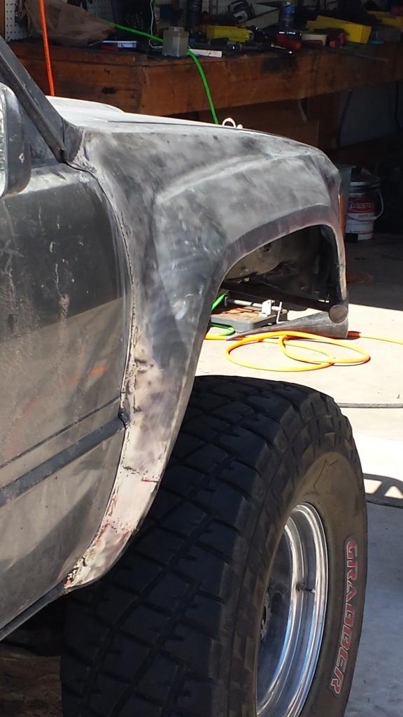

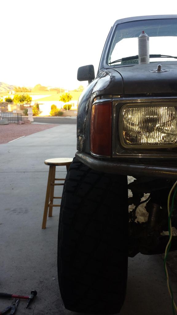

so i purchased a set of glass fenders for my truck and what i recived isnt what was in pic.so now i cant afford to buy the right fenders for my truck.im trying to sell the glass set.because of this it led me to under take this.a set of completly metal set of high clearance front fenders made from two fenders welded together.and some custom free hand metal shaping to blend the two.the result will be seemless to the eye but look baddass.ans in the end cost me almost nothing but a whole lot of time..................so for starters heres the pick of the stock fender for referance.

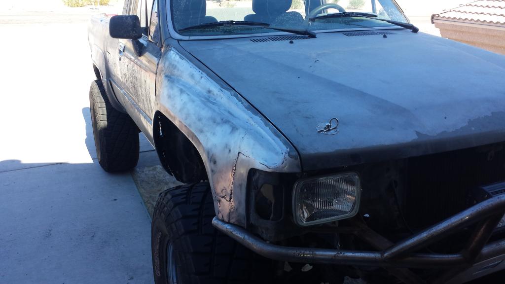

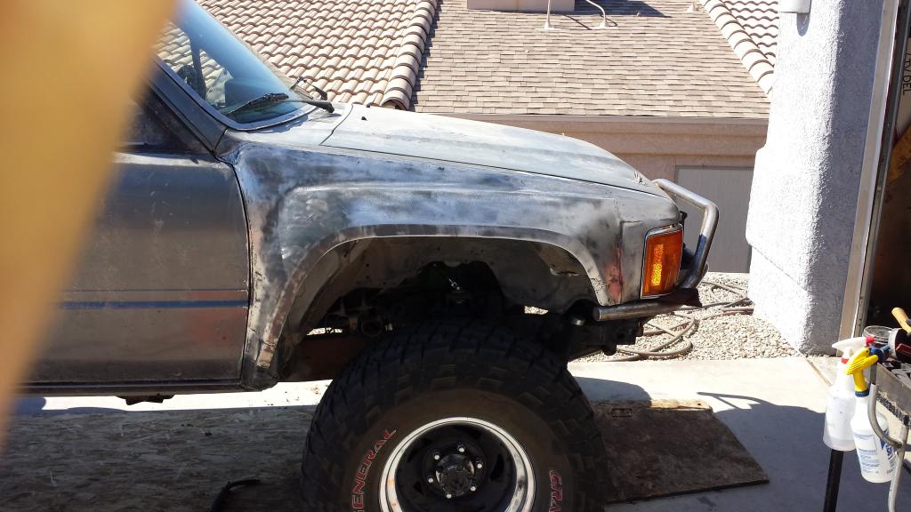

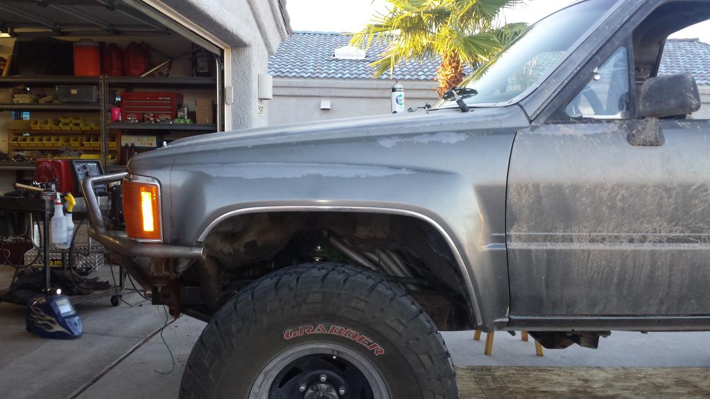

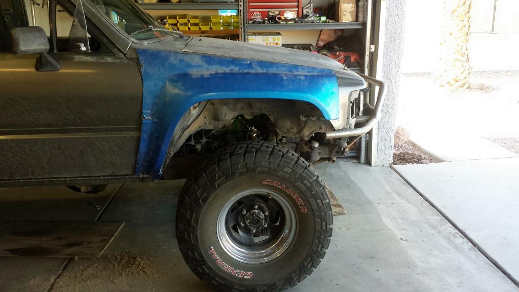

so i cut back the stock fender thats bolted to truck a good bit to give a firm base to weld my chopped up second fender to.i raised the factory fender opening 3" and pulled it back 1.25".but heres the kicker i kept the whole factory sqaure flair section.heres the pic with it just screwed in place for mock up. you can already see how much i cut off the top.

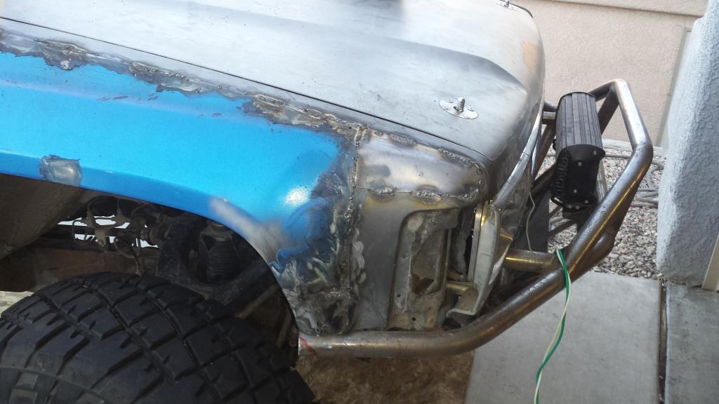

and some more after cutting the top layer fender back to match the door line i also got the top fender to lay flat and follow the under fender lines perfect.please take note in the gap in the front of top fender to bumper when looking at the next set of pics

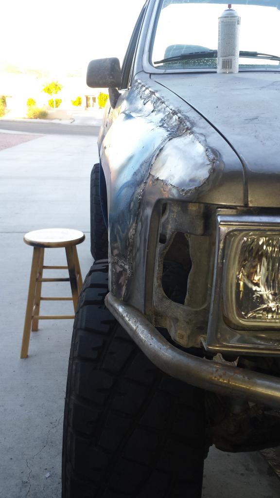

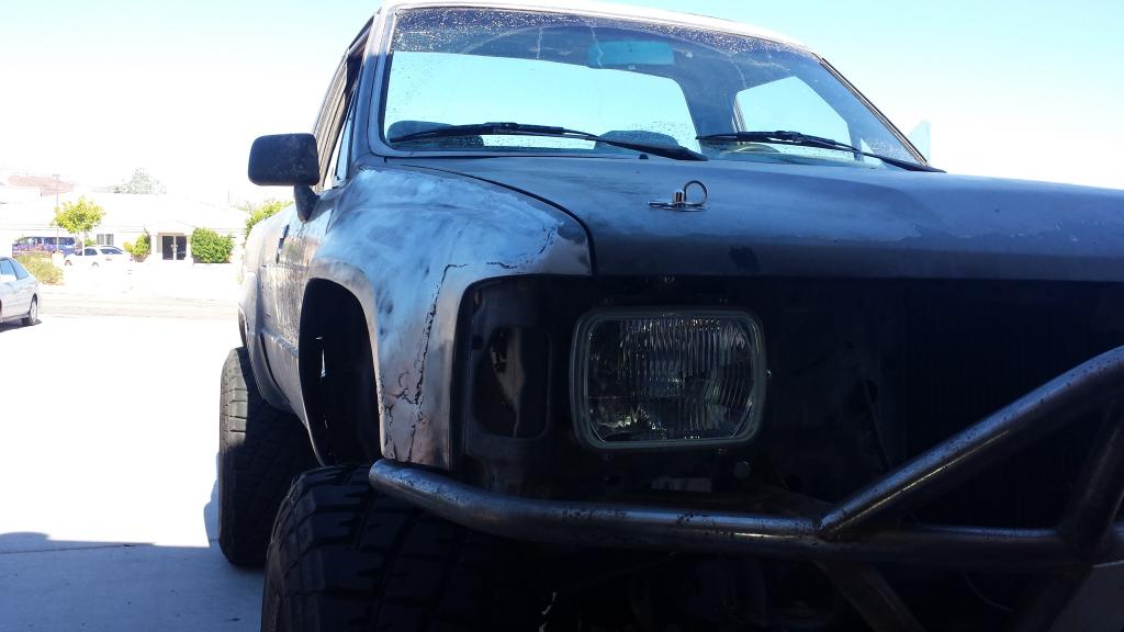

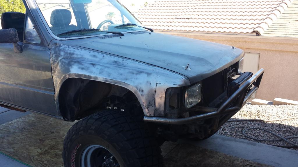

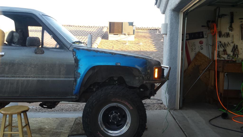

and heres more after tacing it all up and shaping a new top nose peice it follows the factory lines perfect.and extended the front of fender to meet the bumper it also folloes the curvature well.so after i fully weld it and grind it back down and with a little body filler they will look seemless the to eye.

Awesome job on the nose piece. How much higher are these ones?
Old 08-06-2014, 07:22 PM
azdesertrunner83's Avatar
Join Date: Jun 2014
Posts: 19
Received 0 Likes on 0 Posts
3" higher and pulled back 1.25" and thanks i hand shaped that piece from flat steel i put my body dolly in my vice to secure it and just started hammering away with my body hammer till it took shape then trimmed to fit.it took about an hour to get it just right.

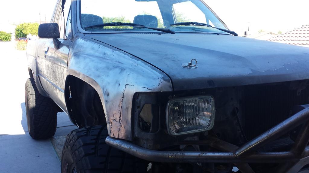

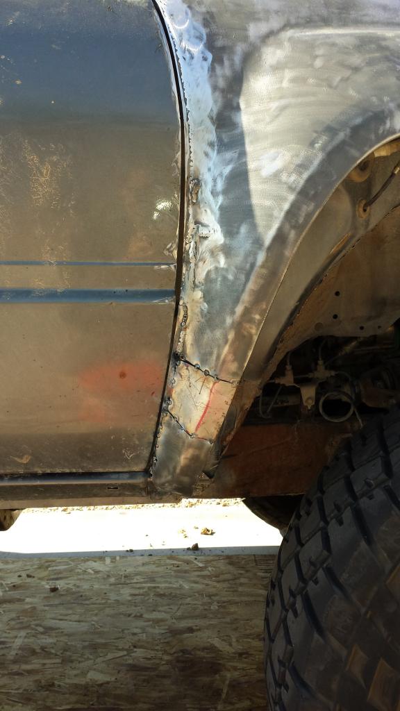

ok so im all welded up i still need to pull fender and do some more detail grinding along the door edge cant get in there with it on the truck,in on pick you can see the filler i shaped from flat stock so that i could bring the fender all the way back down to the cab base. it will all grind up real smooth and look dam good after some lite body filler is applied.

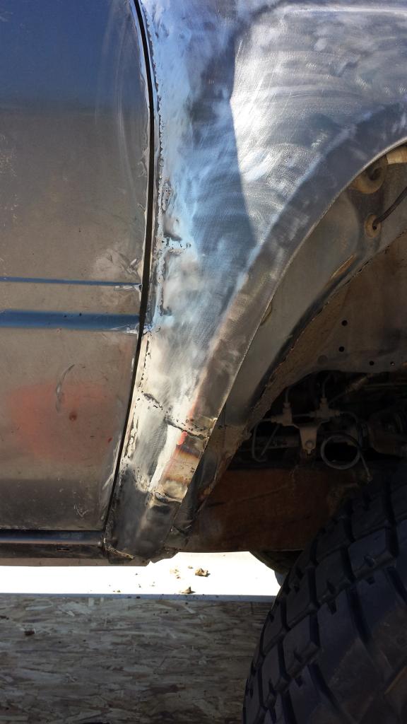

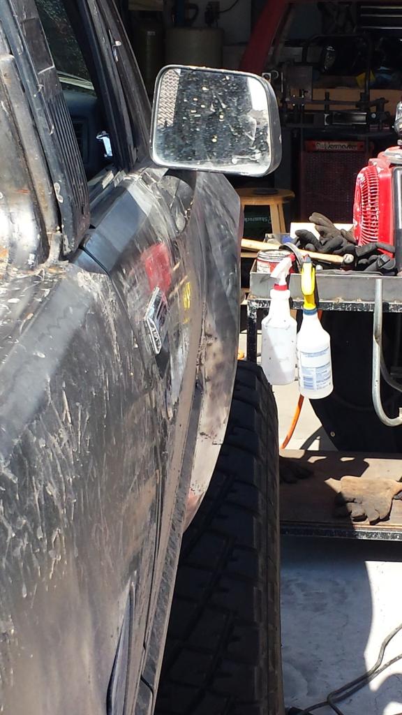

and heres some pics of the welded and semi grinded rear half again i need to pull fender to finish grinding smooth.notice the fender meets the bottom of cab now.

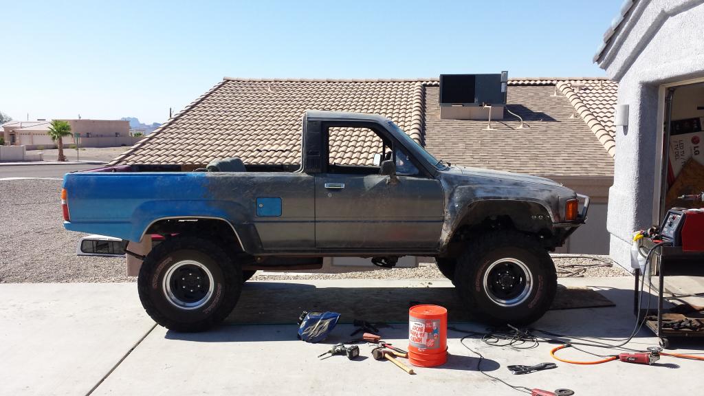

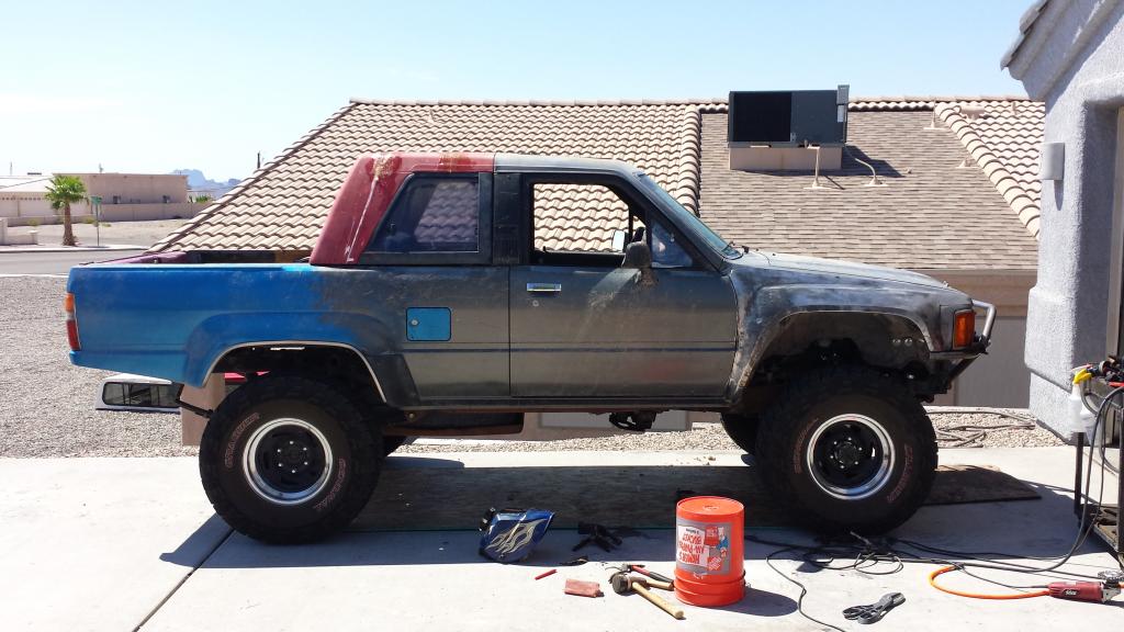

and heres a pick of the whole truck i plan on cutting a little out on the rear fender wells too.
and a couple with my custom top im workin on
[IMG]http://i1278.photobucket.com/albums/y505/d83/20140809_104023_zps6a645431.jpg[/evinheplerIMG]
