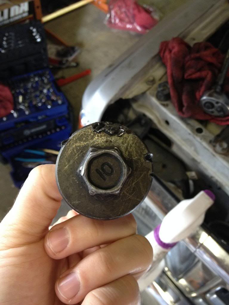

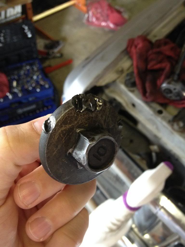

Hey guys, first thread and first post (long time lurker)
To start this is not another "how do i get this friggin thing off" thread (I'm pretty capable of utilizing the search function).
I just purchased my first Yota(86 4runner SR5, 190K) and have been tearing into it (learning a lot about how vehicles work in the process). My first priority was fixing any leaks. I noticed a hot nasty smell after driving and attributed that to gear oil leaking(more like being thrown) from the rear output shaft on the transfer case onto the hot hot hot cat. converter... all fixed.
My current endevour is replacing the front crankshaft seal as well as the oil pump gasket. I noticed oil being flung from the pully, onto the belts, and all over the front of the engine. Currently the car is all torn apart, ready for a new gasket and seal. With all that background here is my question,
Is this bolt okay to reuse? Should i apply some extra sealant to the threads? It looks like someone had a hell of a time getting that thing off (I had surprisingly no issues). The part is almost 20 bucks at the stealership and I'd rather not spend money if I don't have to.
Pics:

The seating surface doesn't seem to be affected, so I'm thinking its OK. Also for the oil pump gasket, do I need to use any sort of sealant(like I said, I'm learning one step at a time!).

That bolt doesn't look the greatest. I don't think sealing is an issue with it, I think that if you can torque it properly when you reinstall it, your biggest risk is not being able to uninstall it again in the future when the head strips. If you think it won't strip, just file down the high spots around the flange and reuse it.

What did they DO to that bolt? If the mating surface is ok I'd run it. No sealant should he required for the oil pump gasket (the o ring looking thing). Check to make sure you don't have a groove worn into the crank where the seal rides.

Yeah lol looks like someone tried to break it loose with an impact, had problems then resorted to the olé hammer and chisel per say to break it loose. Damn things are torqued tighter than hell!
But to answer your question it should be fine to use just be careful not to round it off anymore than it already is. No sealant is required for the oil pump but do not install the o-ring for the oil pump dry!! Put some wheel bearing grease or some oil on it before install. And try to torque the bolts in sequence if you can. Do that and you'll be home free

It is your vehicle but I would throw that bolt out.
I don`t get along well with rounded hardware .

God, I'm glad somebody said that! Here's the part for $7: http://www.toyotapartsoverstock.com/...010516031.html (you have to use your VIN to be sure; they are variants but you can browse and get the right one).
I know those $20 add up, and pretty soon you're spending $80-$100 to make sure you do the job right. Divide it by the number of hours it will take you to replace that crushed part and saving $100 translates into $2/hour. Your time (and sanity) is worth a little more than that.
Incidentally, what's the specified torque on that fastener? (hint: if you have the 3VZE, it's more than you could put on it by standing on a breaker bar!). Someone in the past (with the wrong tools, no doubt) used a hammer and chisel to get it off. You, on the other hand, had no trouble getting it off (but had a lot of oil leakage). See the connection? I'll bet it was put back on "hand-tight", which is about 20% of what it should have been.

Yes, New Bolt time...

The bolt looks fine, but If it were mine, I would replace it.
