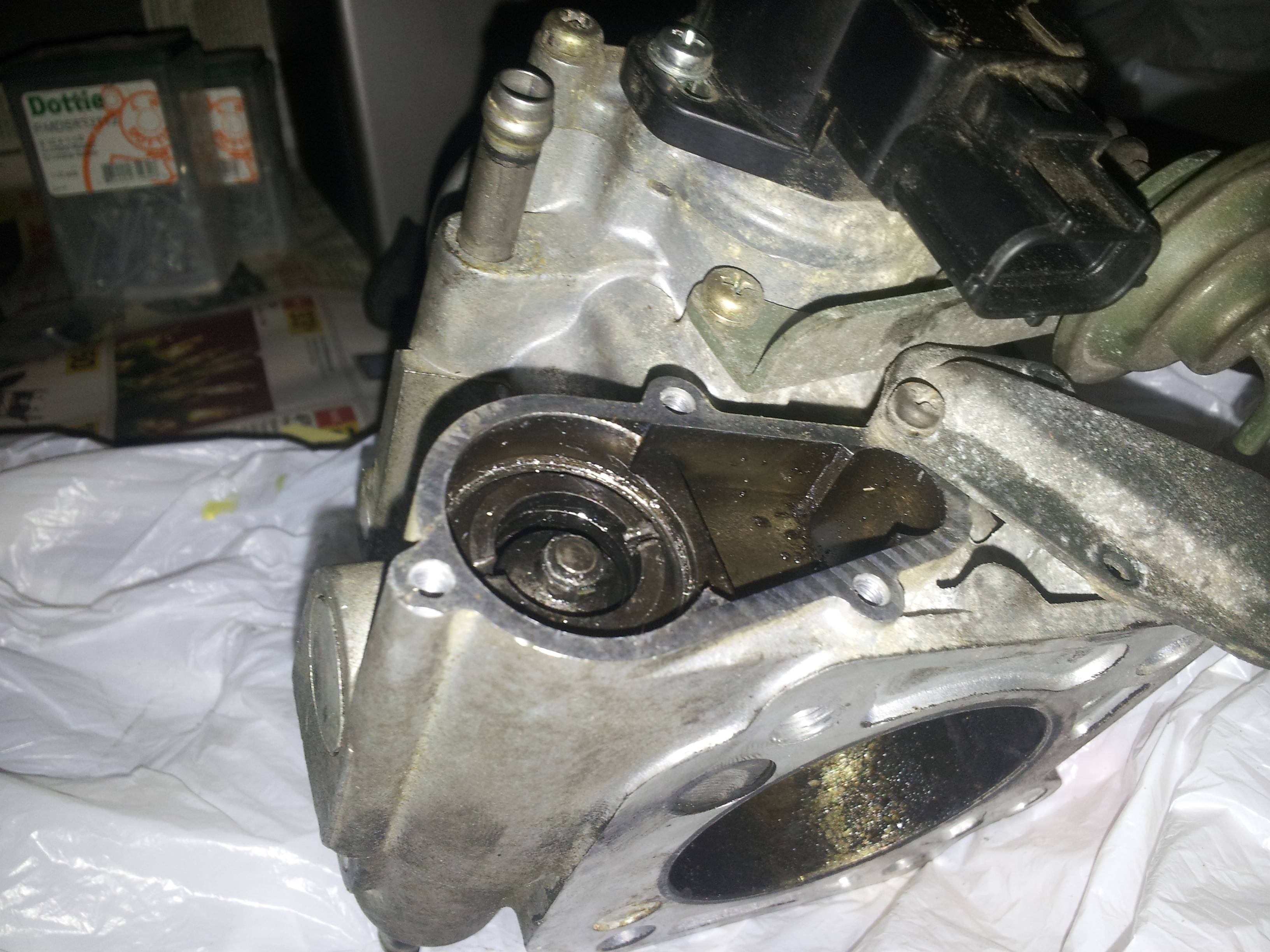

alright so i've narrowed it down to the IAC valve! and it indeed looks suspicious
But i've found almost no information on disassembling or what it's even supposed to look like. So if anyone has wisdom on the subject i'd love to hear it!

so it's a blow head gasket (which still doesn't explain all that loose coolant in the throttle body but whatever) ˟˟˟˟ this 3vze hogwash i'm swapping it out for a 5vzfe, auto wrecker says he's familiar with the swap and he'll sell me everything i need to do it for $1400.

How did you determine it was the head gasket? The TB does have coolant flowing through it. I sprung a leak externally at the hose clamp and just by passed it one day, (Very bad idea) Needs to have coolant flow through the TB. Can you Cap one end and pressurize the other?

oh i didn't think to take a picture, i just ran an 8" length of 1/4" copper tube under the Throttle Body to bypass it, but even after i did that it still pushes tons of white smoke and ran awful after about 1 minute, it sounds like a nasty miss but theres no coolant coming out of the throttle body anymore! so i still don't get that part.

Bypassing the coolant through the throttle body = 1500-2k Idle, HOT engine temps. Theres a thermal switching and it just keeps the choke on non stop. how many miles on the truck? Head gaskets seem common on the 3.0. I just got done doing one a few weeks ago. Tons of smoke in the exhaust, and radiator cap removed you could feel the pressure comming up when you put your hand over the open cap. Have fun and good luck
