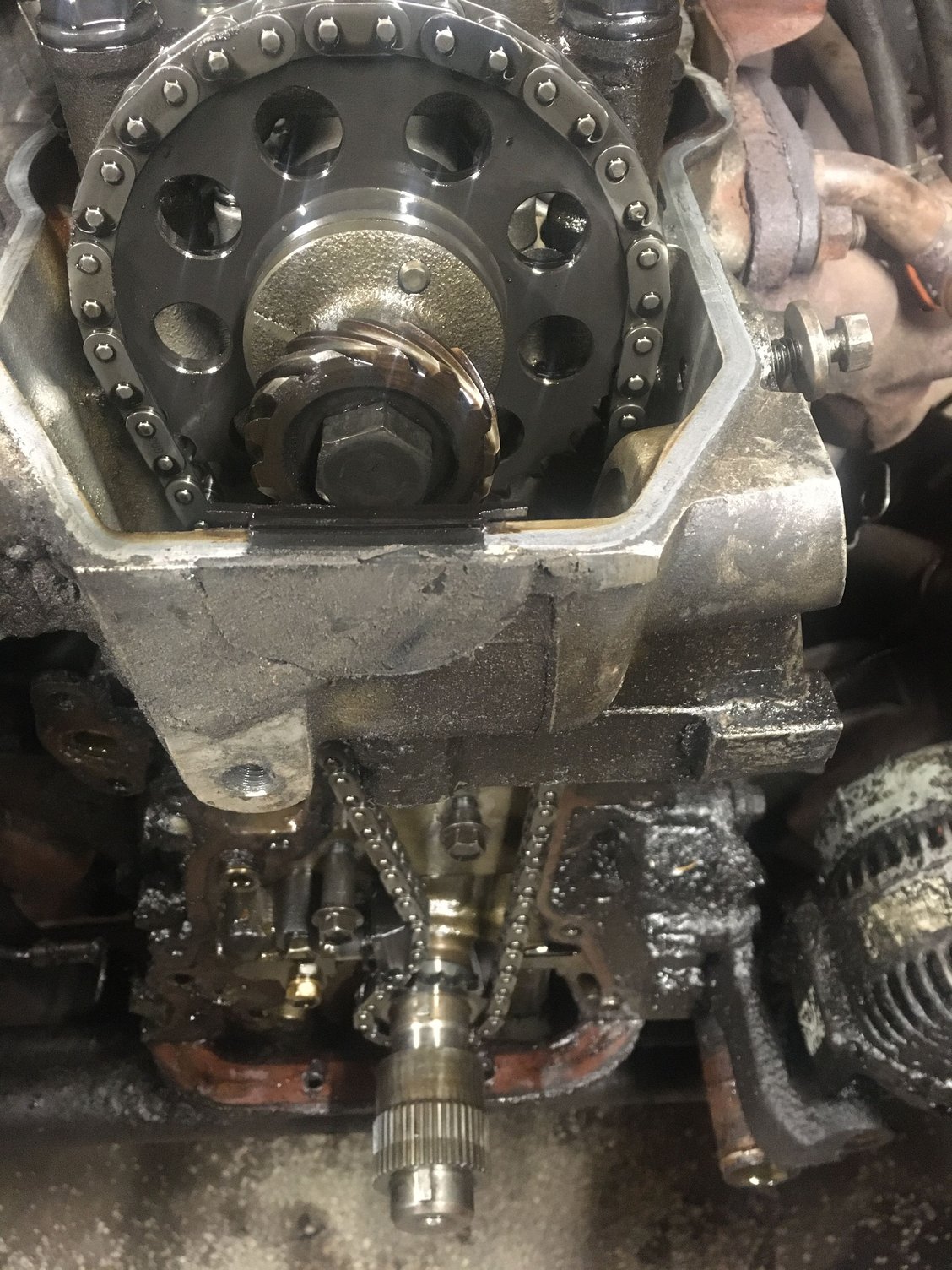

I am replacing timing chain on my 22 RE...timing cover off and engine has sat for a week. Drained oil today and couple ounces of antifreeze came out first and it was clear. No milky oil under valve cover nor was there any milky oil on dipstick the day I stopped running truck. I believe the coolant spilled into front of oil pan and settled to bottom when removing timing cover....any thoughts..I know...should have dumped oil before removing timing cover...
this is how I found positions of cam and crank when opening the engine...must have jumped a couple teeth..both timing chain guides broke...the guide on driver side was in pieces while the guide on passenger side was intact but cracked.

You should pull the head. Pan too, though some pans are hard to get off without raising engine. If you decide to leave the pan on you'll need to figure out how to get the broken pieces of the guide out. A timing chain job with head in place has high risk of leaking oil immediately. It's just not worth it. Some short cuts aren't bad where if they don't work redoing it the right way is no big deal. This repair is a big deal if the short cut fails.
The guides break because the chain hits them as the chain stretched and the tensioner was already maxed out. Now two schools of thought. You can buy guides made out of metal. They won't break if hit, but it doesn't change the fact that chains will stretch. The guides breaking is what often alerts owners to the need of a new chain. The metal ones may allow a driver to keep running the vehicle until the chain stretches to the point where it starts skipping teeth and risk bending a valve. so pros and cons both ways.
OSK has a decent quality kit for the chain. the weak link in many of those aftermarket kits is the tensioner. OSK tensioner is on par with oem. I've seen aftermarket tensioners fail very soon. Sometimes less than a year.
