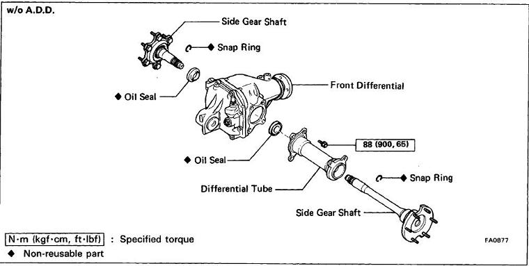

the gears aren't black, they're just covered in thick-ass oil at the moment....almost literally EVERYTHING at the shop was covered in oil. not sure why the oil is so thick on it though.
haven't had time to mess with any of it other than take a quick pic but i was able to do a quick check of the gear pattern in the 3rd since the oil is so thick on the teeth - everything seemed fine. haven't opened up the front diff to check it out yet either, but i'm sure it should be fine as the 4runner only had 144k and looked like it had hardly ever seen dirt before. definitely going to freshen up the CBPL on the 3rd. not sure if i'm going to go with a full rebuild on it at this moment nor am i sure i'm going to get a lockright before i put it in - trying to save ups some serious $ for a rock to put on the gf's finger. for the front diff i've looked at the options and decided that it is best to just swap out the long side. my decision on this is based on the ease of swapping the tubes and the fact that side by side the non-ADD long tube is visually much beefier: http://home.4x4wire.com/erik/diffs/IFS_diff2.jpg

The 'c-clips' are actually snap rings, my terminology was a little off as it's been awhile since i've messed with IFS
Here's a tear down to show you what to look for.

I just went through the exact same thing recently. I would say go ahead and swap out the ADD. Thats what I did, it looks a lot cleaner and its not that big of a bitch you just gotta remember to replace that seal in there and seal everyting up when you put it back together. Its also a good opportunity to clean everything up and my 4.88 diffs bolted right up to my 4cyl axle i just left the abs sensor in there and cut the wire. I would also recomend going with the rebuild kit cause your not gonna wanna mes with it later if it goes bad, also it could hurt your gears and if your saving for a rock your gonna wanna do all of this before you get on that whip because be honest, afterwards it probably wont get done lol.
