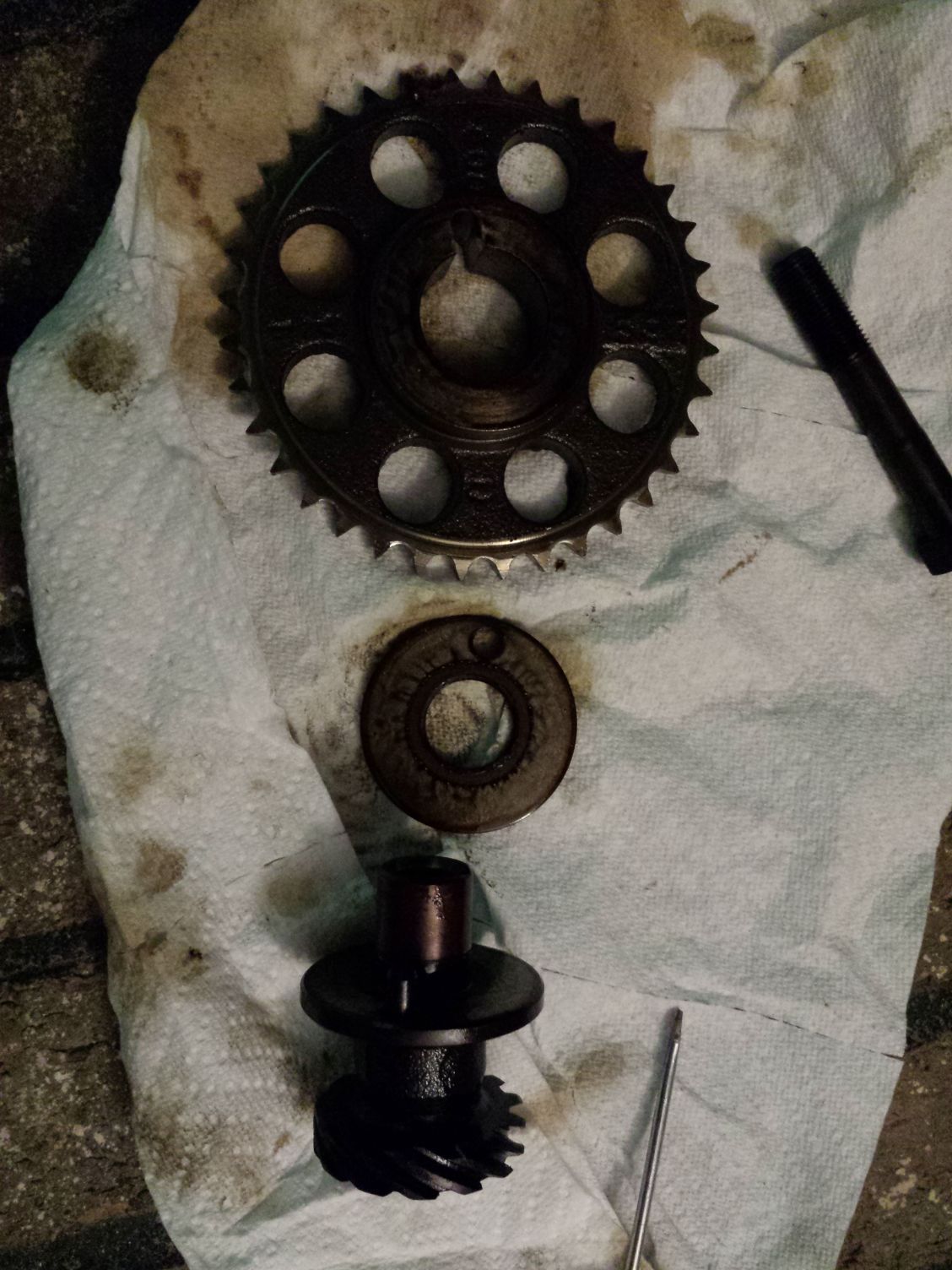

another common misunderstanding.
Do not confuse the camshaft locating pin (dowel) with the indexing dot!
I can't post a photo, but someone else already has. (Thank you)
Note the relationship of the locating dowel pin, the indexing dot, and the cam sprockets teeth and groves.
The locating pin alignment with the valley, the indexing dot on a tooth.
The pin goes at 12, and the indexing mark will be just to the left.

First my stupid question of the day. Does it matter that he might have been TDC but not on the compression stroke? As long the rotor is pointing near #1 plug wire my still asleep brain says no.
.... And a little food for thought to get the old brain fired up
The post above mentioned the mechanical fuel pump it's drive wheel and the spacer used by the injected engines. I never really thought about the relationship of the distributor drive wheel and it's distance from the front face of the camshaft.
Isn't the fuel pump wheel brass, or is that just my bad eyes and it's oil varnishing that makes me see them as a yellow (soft) metal? Even if they are stamped steel they are still on the thin side and suceptible to crush damage from either over torquing of the camshaft bolt or multiple reuse. How much difference does this make on the ignition timing if it's half as thick? How does the spacer, used on injector engines, handle over torque and reuse?
These are the sort of variables that make each engine unique and why we have to tune them as individuals...

When I was installing the head I remember something slipped and the chain location moved unfortunately but I set it with using the timing mark on the crank pulley.
So the two shiny links on the chain are not accurate but I know that.
Also after everything was back on, I tried to start it and it would not start. A fireball shot out of the carb and I had a feeling I had the distributor on 180* off so of took the distributor out and turned the engine over 180* then re-installed the distributor and it fired right up.
I think I still have my original distributor but I'm not sure.
I'll check in the morning when I get home if I can remember. The one I have now is a used one from ebay.
When I had the head shaved I asked and the guy just told me it only needed very little removed. Something like 8 thousands
Thank you so much Co_94_PU
