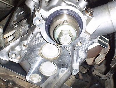

Am trying to finish up after replacing my blown HG's on my 3.0. When I was about to check valve clearance with the crank set at 0TDC I noticed that the two timing marks on the camshafts don't line up with each other or with the mark on the crank pulley. The driver side cam has the timing mark pointing straight up, while the pass. side points toward the outside of the engine bay. Should they both line up at the 12 o'clock position? I'll attach some pics. Thanks for any help

Without the belt, they won't stay at the 12 o'clock position. Because of the shape of the lobes, the cam will likely flop over when you remove the belt. You don't need to worry about lining them up until you are putting on the belt.

Thanks ChickenLover! You've saved me from some un-needed re-bolting.

Both will be straight up 12 oclock. The pass side cam will want to go right to straight up, while the drivers side will go there, but with vavle spring p ressure. Once you get the tin on, you will see the marks. Dont forget, each cam gear goes on different, drivers side is flipped so the flange is out, pass side, flange is in.
