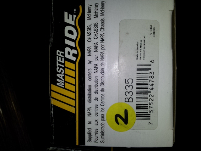

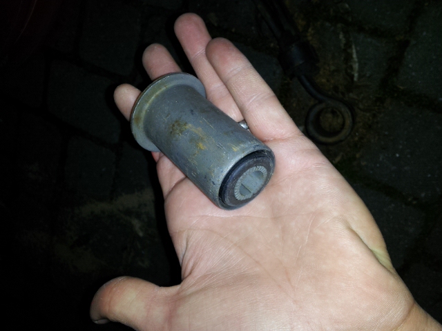

I went to NAPA and ordered spring bushings for a 1996 1/2 ton chevy truck. What I got were these:
I looked up the part on NAPA's site (B335) and it looks like these are for an S10 or a van?!
http://www.napaonline.com/Catalog/Ca...335_0131664498

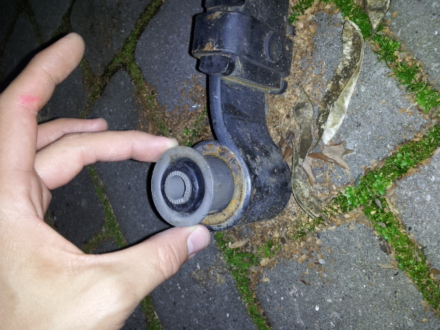

I took one out to my springs to see how they would fit. They slip right in - it's snug, but I can easily turn them, so I'm guessing they are not snug enough and should be super tight (I've put in bushings in my Datsun before and they are TIGHT).

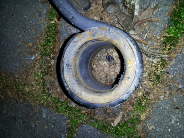

Here's the end of the leaf spring with the old bushing gone:

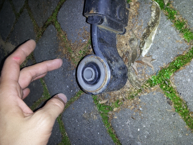

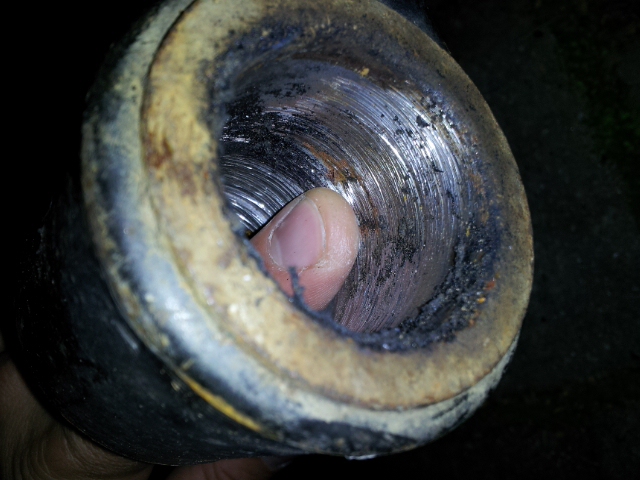

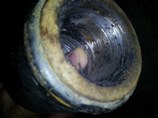

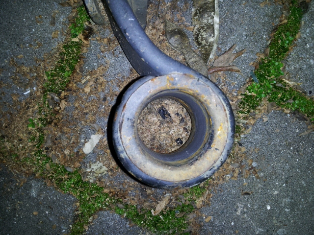

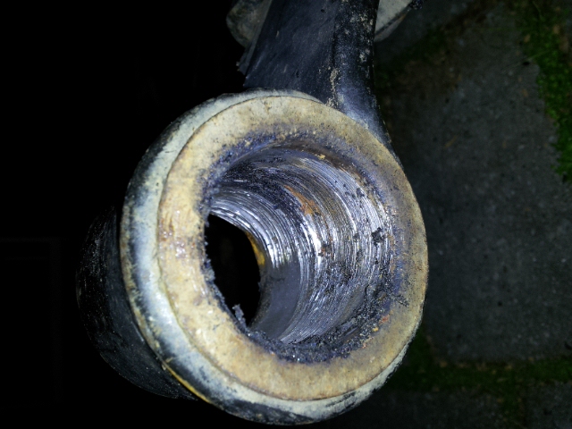

This is the other end of the spring - notice that there is marring on the inner metal sleeve I mentioned earlier - hole saw must have got it...

I think what I SHOULD have been sold are these:
http://www.napaonline.com/Catalog/Ca...977_0324828446
So my questions are:
1) Did I get the wrong ones and should I get the ones mentioned above for the 1/2 ton?
2) Are the metal sleeves with flared ends supposed to stay in the "eyes" of the leaf springs (and the new bushings slide in)?
3) Is that marred metal sleeve going to be an issue? I'm thinking no, since the new bushings have a metal outer sleeve anyway - am I right?
4) Since the replacement bushings are flared only at ONE end, does it matter which end faces in/out?
Thanks in advance!

Regarding the bushing, the one you have is about 4mm smaller than the one you were looking at, 2mm on each side. Do you have the much play it? It doesn't look like it, but you don't want any play in your steering or suspension usually. Ya know that I assume, but just in case. Tighter is better! I tend to give the parts-counter person the benefit of doubt, but you might have got the wrong part for your donor type. But then it might of been your removal method also. You forgot to account for the saw kerf of the hole saw. Use a smaller hole saw size so you cut thru the middle area of the bushing, eg you bushing will come out in two pieces.
Also the existings sleeves look to be a 2 piece unit. You can check the donor vehicles manual and find out if they are ment to be replace.

Looks like you got the wrong bushings.
And you need to push/cut the old sleeves out of the springs.
The new bushings should be pounded/pressed in.
Remove the old bushings by whatever means necessary. I cut the bushings where the gap in the spring is, then curled the bushing inwards.

So, I borrowed my brother's sawzall and cut both old bushing sleeves through the "slit" in the loop at the end of each spring. I thought the sleeves would easily knock out once I cut through them, since the tensile strength would be undone...but I was wrong! I had to take my punch and hammer to the falred edged for about 15 minutes on each one, enough to collapse the sleeve on itself. They finally came out.
And now comes the interesting part....The bushing holes at each on the the spring are NOT THE SAME SIZE!!
One bushing eye (with sleeve out) measures 2.0" I.D.
The other bushing eye (with sleeve out) measures 1.75" I.D.
The spring, eye to eye, is 62.5"
The spring width is 2.5"
The guy I bought these from (over a year ago LOL) said they were chevy springs - he had the sky kit and everything, but decided to go another route before he installed them.
Do these springs have bushings that are different sizes - is that normal??

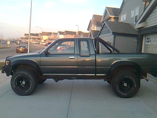

You've got something wonky with your springs.
The bushings are the same front and rear from what i can remember.
You say you have a 4" bracket lift in the front and are only planning on putting a 1" block in the back?
I'm guessing your front suspension is sagged out (suspension arms are flat/parallel to the ground).
When I did my lift, I had a sagged out front suspension with the chevy leaf swap. Once I cranked the torsion bars and got the front suspension to 1" lower than the rear (it's truck and hauls stuff, so you don't want to be dragging the rear when hauling).
There's a 3" body lift in the first two pics, and not the last one.
