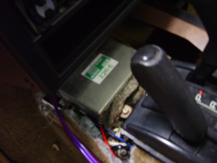

This is the ECT unit.

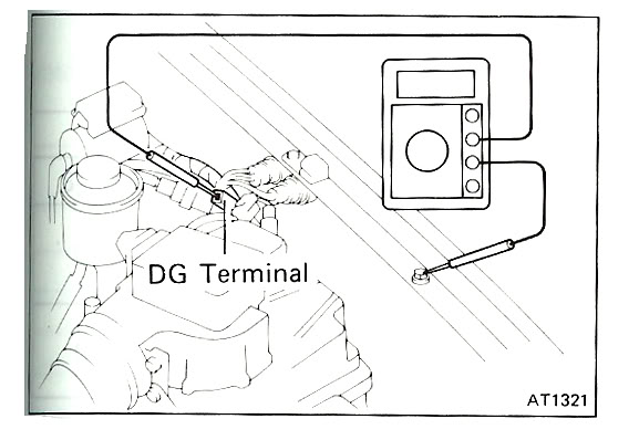

Hi there, I'm also having similar problems to the OP. I have an '87 runner with auto transmission. The 3rd gear started going out and now it does not go into 3rd at all. Goes from 2nd to overdrive. The OD light blinks when driving but I cannot get it to blink for diagnostics. I tried to ground the following plug and turned the ignition without starting the engine as the FSM describes but the OD light just stays off.
I've also tried the T-E terminals but that does not turn the OD light on either - just makes the check engine light flash (which BTW shows no codes). Am I doing something wrong? Could someone highlight which pin connection I am supposed to short? The FSM says "DG terminal" but its not clear where that is. The picture above is the only thing i could find.
If that is the correct pin, anyone know why the OD light wont flash with the engine off but ignition on?
