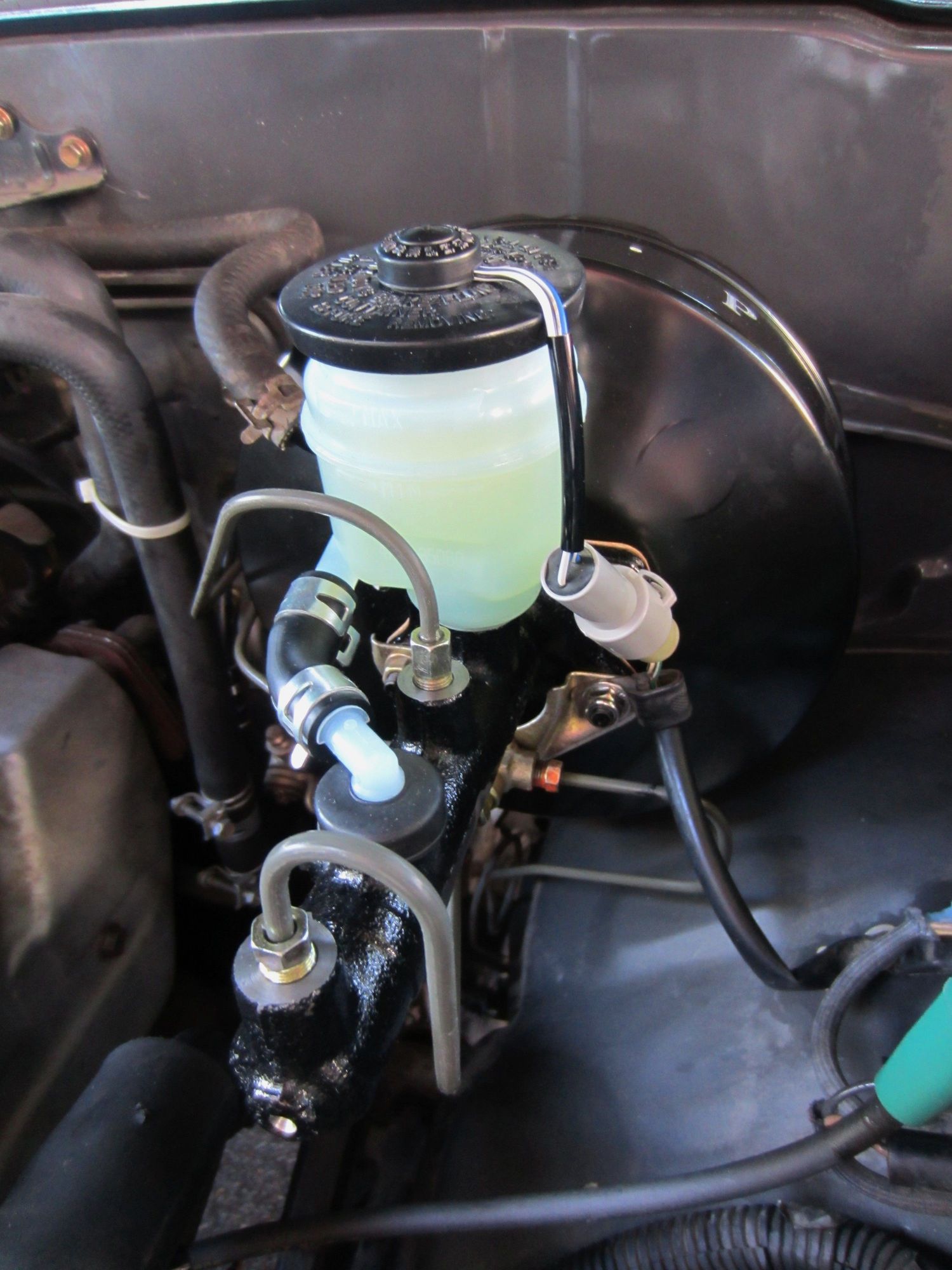

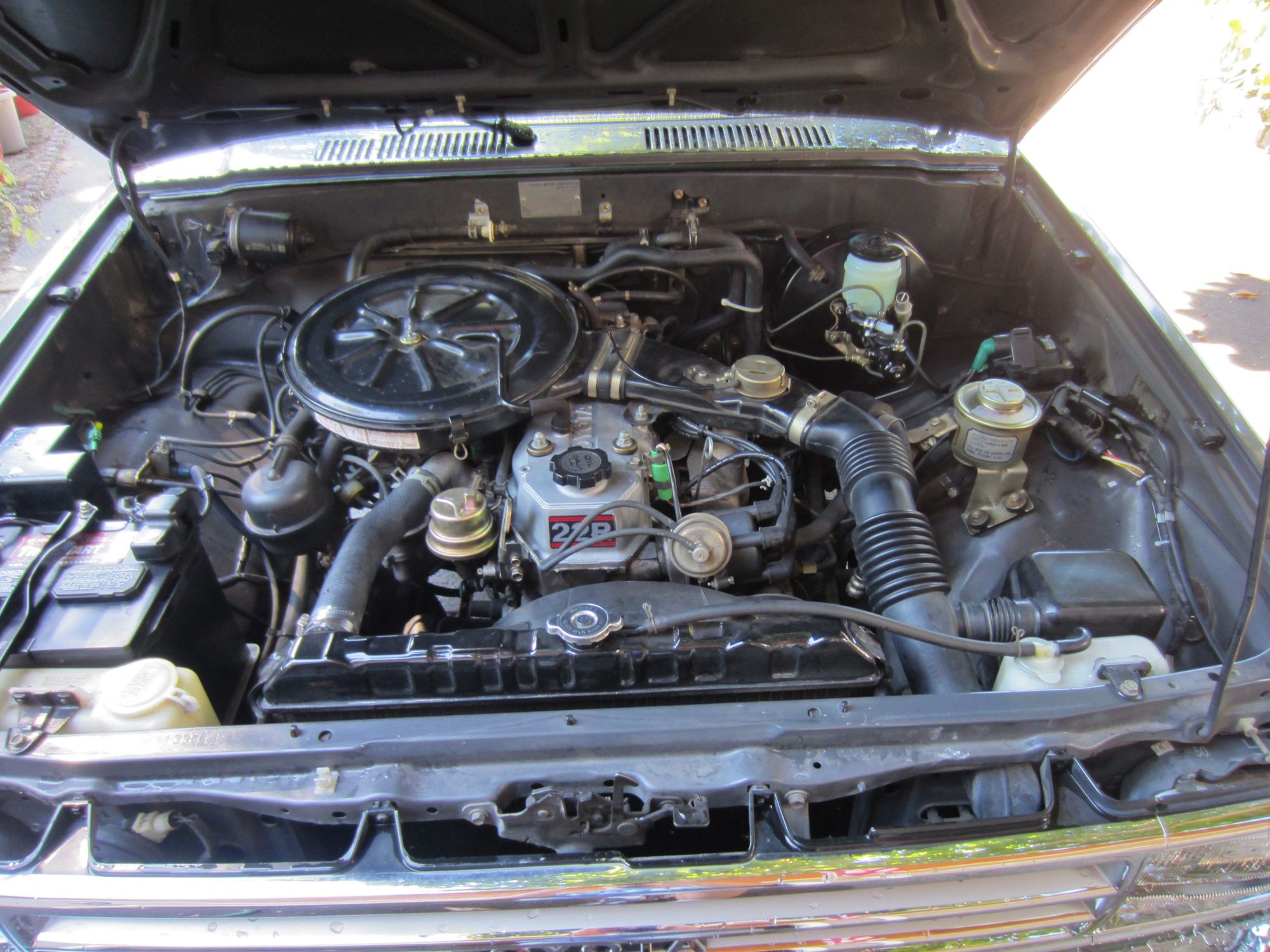

Here is what my truck looks like now:
https://cimg9.ibsrv.net/gimg/www.yot...5926150a61.jpg
https://cimg4.ibsrv.net/gimg/www.yot...f6aba8e3ac.jpg
Sorry for any confusion...
