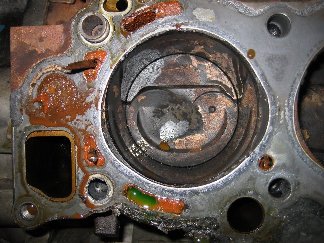

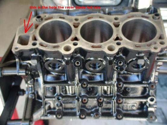

Here are a couple of pictures for reference. Does anyone know for sure if that hole leads directly to the oil pan?

Well, it certainly looks big enough to pass a razor blade in that picture.

Goes straight to the pan.

I might be completely wrong here but isn't that a coolant passage? From what I can remember anyways. I tried to look through all my other pictures but can't find one that shows it well. Looks a little large to be an oil passage too.
