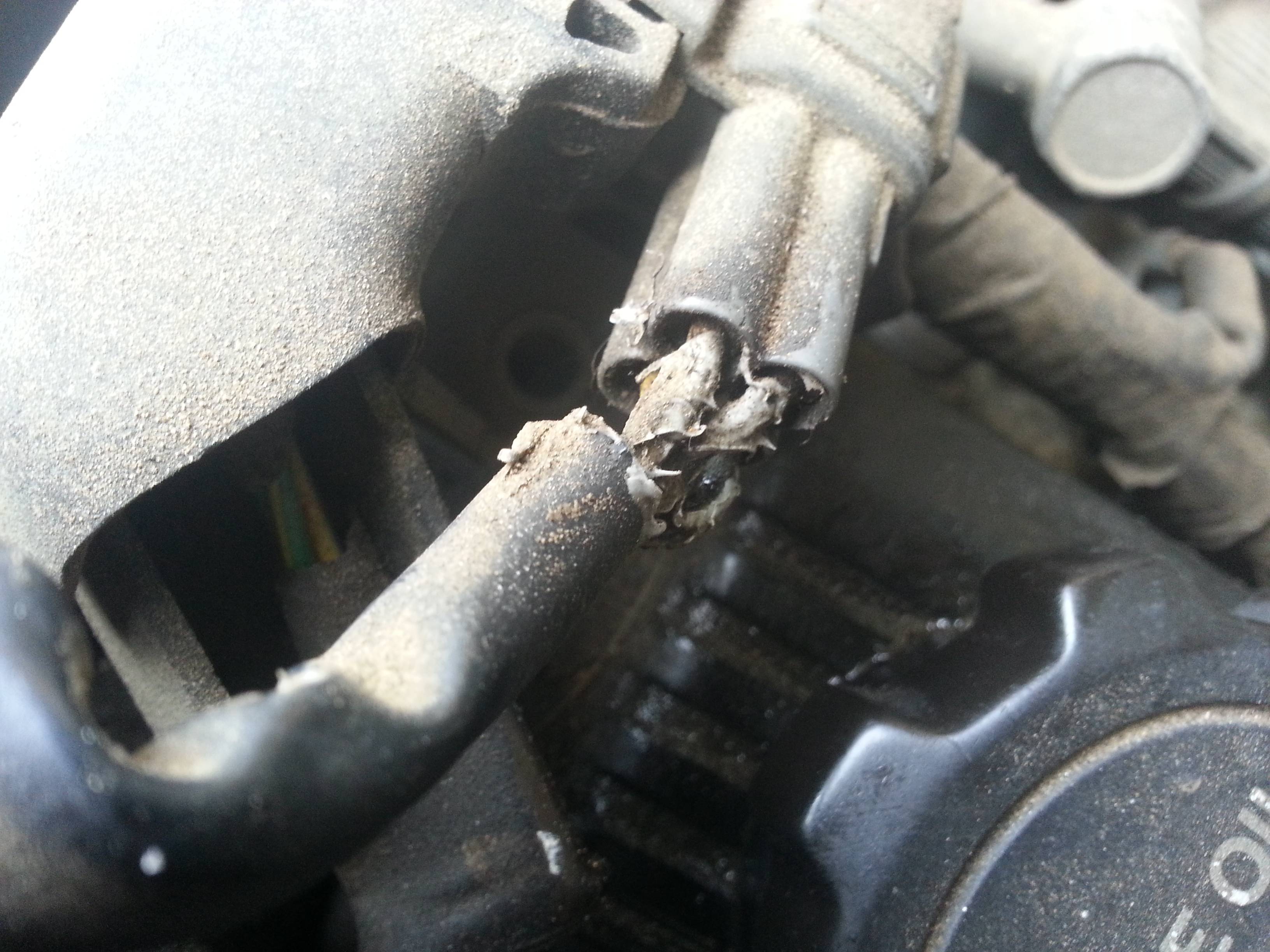

Cel kicks on for a minute several times a day. When it does the truck drops idle and dies. If u catch it right I can bring it back running. My dizzy plug, that plugs into the engine harness is frayed. Like..its crap. I've been told that's the issue. It plugs into rhe stater inside the dizzy. Can't find it at a yota dealer and they want 324$ for th housing.

Try and pull codes to see what exactly is going on. Stick a paperclip in TE1 and E1 on the diagnostic port next to the engine bay fuse box and turn the key to "ON" but don't start it. Count the flashes until it loops back around and let us know what you get.
As far as the plug, yes, that will kill the engine. You'll need to go to a junkyard then and find a good dizzy connector from these engines. Cut it off with plenty of wire to spare and solder (do not use butt-connectors here) it to the existing wires.

the engine harness that plugs into the distributor is frayed? Is that what you were saying? I got a scrap harness I can cut the plugs off of and send up to you if you think that would help.. shoot me a pm if you want to try that.
That would be awesome.
Its the plug that comes sort of out of the dizzy and connects to the plug very close to the oil filler cap.
I sent a pm.
