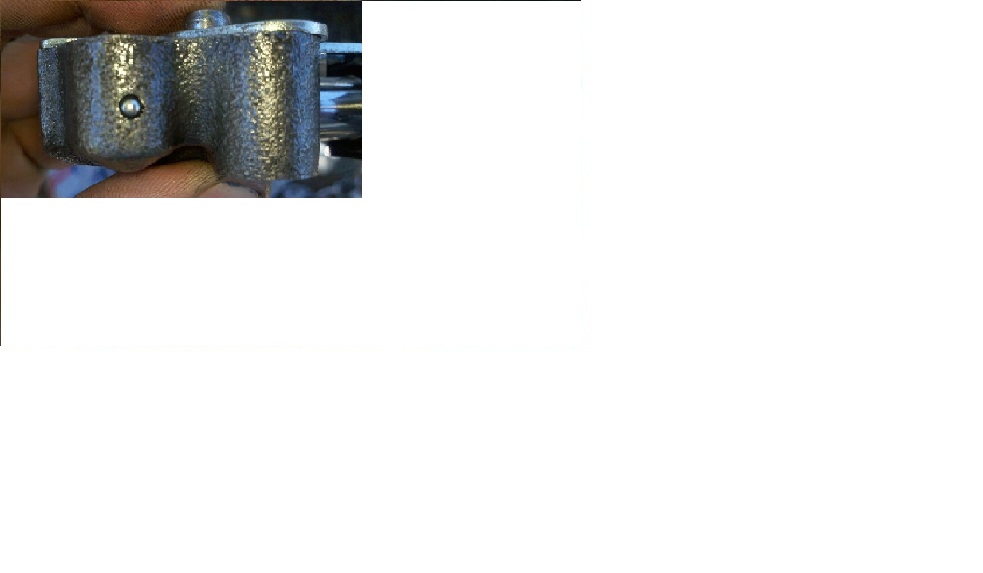

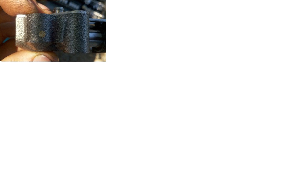

well i finally got it all fixed up today. looking at the tensioners i found my problem. on the bad tensioner there was check ball type plug "sealing" a casting hole, when i pressed in on the tensioner i can see bubbles coming out of that hole, thats where i was losing my pressure at idle.
on the new tensioner (2nd pic) there is a screw sealing that casting hole that actually seals. i ended up with the two different ones because i originally bought the kit for an '87 22r then found out i had an '84 block so the bad tensioner came with that older kit.
