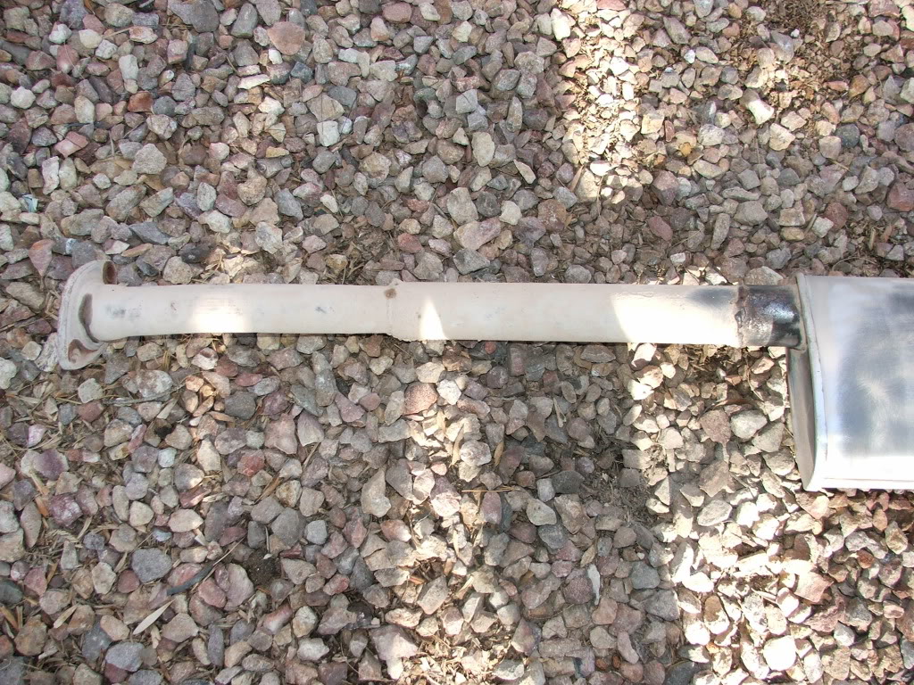

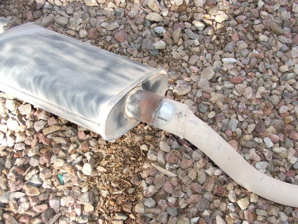

Ok guys, recently on the way home from a trail my ghetto exhaust "slinky" fell off and I could easily rev my engine to 4500-5000 rpms (in neutral). I've since reconnected the exhaust and its back to its same old can't rev pass 4000 without sounding like it's going to grenade the engine. This led me to start investigating the terrible exhaust the PO installed and checking out the catalytic converter. My truck has 220,000 miles on the drivetrain and I doubt the cat has ever been changed. Take a look at these pictures and tell me if you think this cat is bad please. I unsure if I should see clear daylight through a cat or if the baffles should block out most of the light.
I've read that Catco and Magnaflow have good replacements for this truck. I have access to a welder so a universal doesn't scare me but I just want to make an educated decision when the time comes.. Anyone have any more to add on these?
Stupid "Slinky"

Hack Job Exhaust

one way to tell if your cat is clogged is that it will glow red after driving for a good bit and it will smell like rotten eggs.

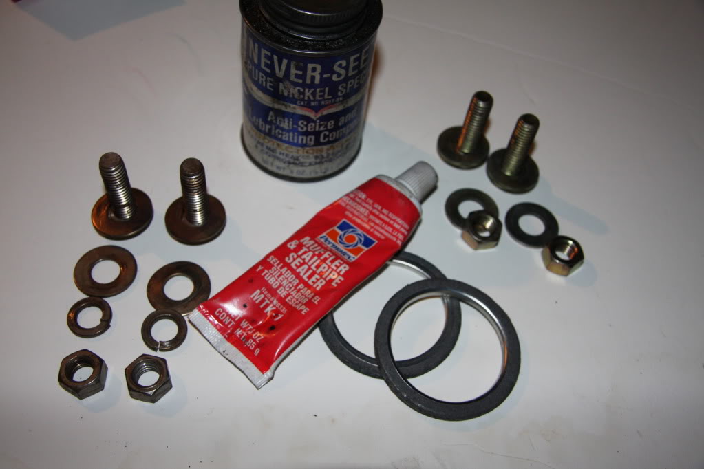

I just replaced mine. I was told via smog test mine was bad. OK fine its been 10 years or so for a replacement. So i put in a new one, and will check the EGR and timing. ppfftt fail me will ya , take that.

Well thats what they said could Be the culprit, i had it anyway, got it a while back. I got it when i was in NH so it must be ok. I think it was around $ 135. from LCE . The bolts n gaskets I had also. My guess is when they fail they clog up, mine looked OK, but then there could be other issues with a cat i am not aware of.

Its not ca legal.They will check the numbers.The reason that they are not allowed to recommenend repair items is because when you tell a guy "it MIGHT be the converter" ,said jerhkoff goes home and replaces the converter,then screams at you when it doesnt pass.Inspectors arent there to fix your car,just to inspect it.Cat converters lose their effiecency from degradation of the catalyst.Clogging just makes them restricted.If a cat is glowing red,you have a really bad rich condition that is fueling the cat.It will melt shortly and then decompose.There is no 50 state carb legal converter.There is California,and then there is the United States.Torqued that front flange down a little tight eh?
