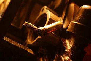

The thermostat and the gasket were replaced. I tried to get some good pics, but we have it all taken apart right now. Basically the big hose that comes from the radiator that goes to the water pump (???) that has the thermostat in it is leaking where it seals up to the water pump (???). This is a 3.0.

pictures
alright, when you are looking at the pics, it is leaking behind the piece that is shown in the picture. it looks like a spacer that is connected by 2 bolts but I don't know if it can be removed. I don't know if this helps, but the piece that I am talking about is a shiny silver, where as the housing unit behind it is duller.

Ah, yes........sorry. Got side tracked.
Here's the FSM blow up diagram of what you're looking at. I could explain, but it would be easier for you to get a real visual of the part in question.
http://personal.utulsa.edu/~nathan-b...09waterpum.pdf
As you can see, it has to come off as one unit. The seal behind your water pump is leaking, if I understand your posts correctly?

Thanks for your help. Sounds like I will be replacing the water pump. Also, the web address came up fine, but a couple of the links inside the document wouldn't come up. For example when it said See Paige EG2-32 and See page EG2-41.
