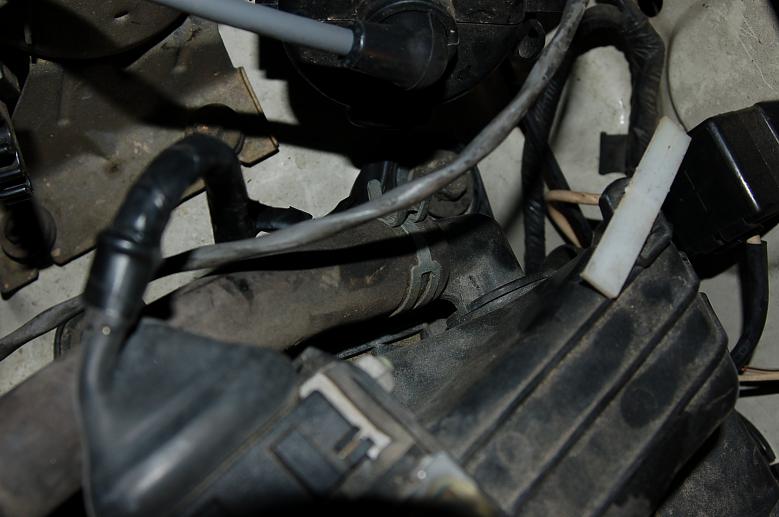

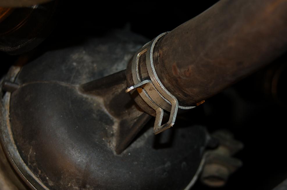

Hoses
I did a quick look around the inlet hoses to the PAIR valve, and all of them looked in good shape. As far as I could tell it did not look like any of the air going into Pair valve was metered. I did notice something though, the small red VSV valve that the vacume lines run to was broken. One of the hoses pulled off the nipple for the posterior hose. I epoxied on the nipple and it seemed to work fine, could glue in the VSV valve be making it stick and causing that noise?

Originally Posted by xzyragon
umm... i got my PAIR valve running through a mini filter I got sittin on the resonator...
does it need to be going through the airbox, because mine works fine without it...
You can do whatever you want with it. Just if it is to "open" then you will hear it gargling. It just dumps air into the exhaust so not a big deal.
