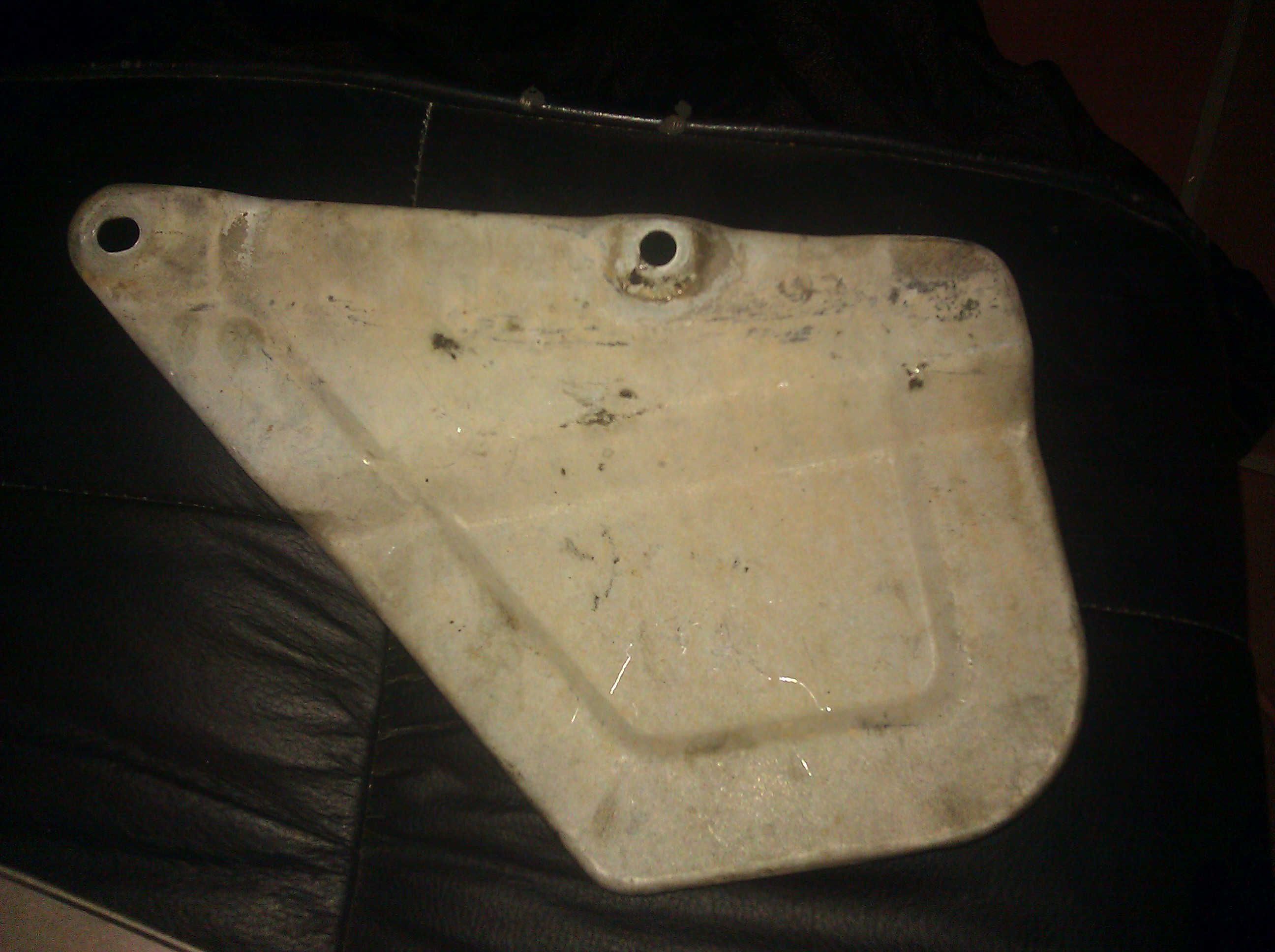

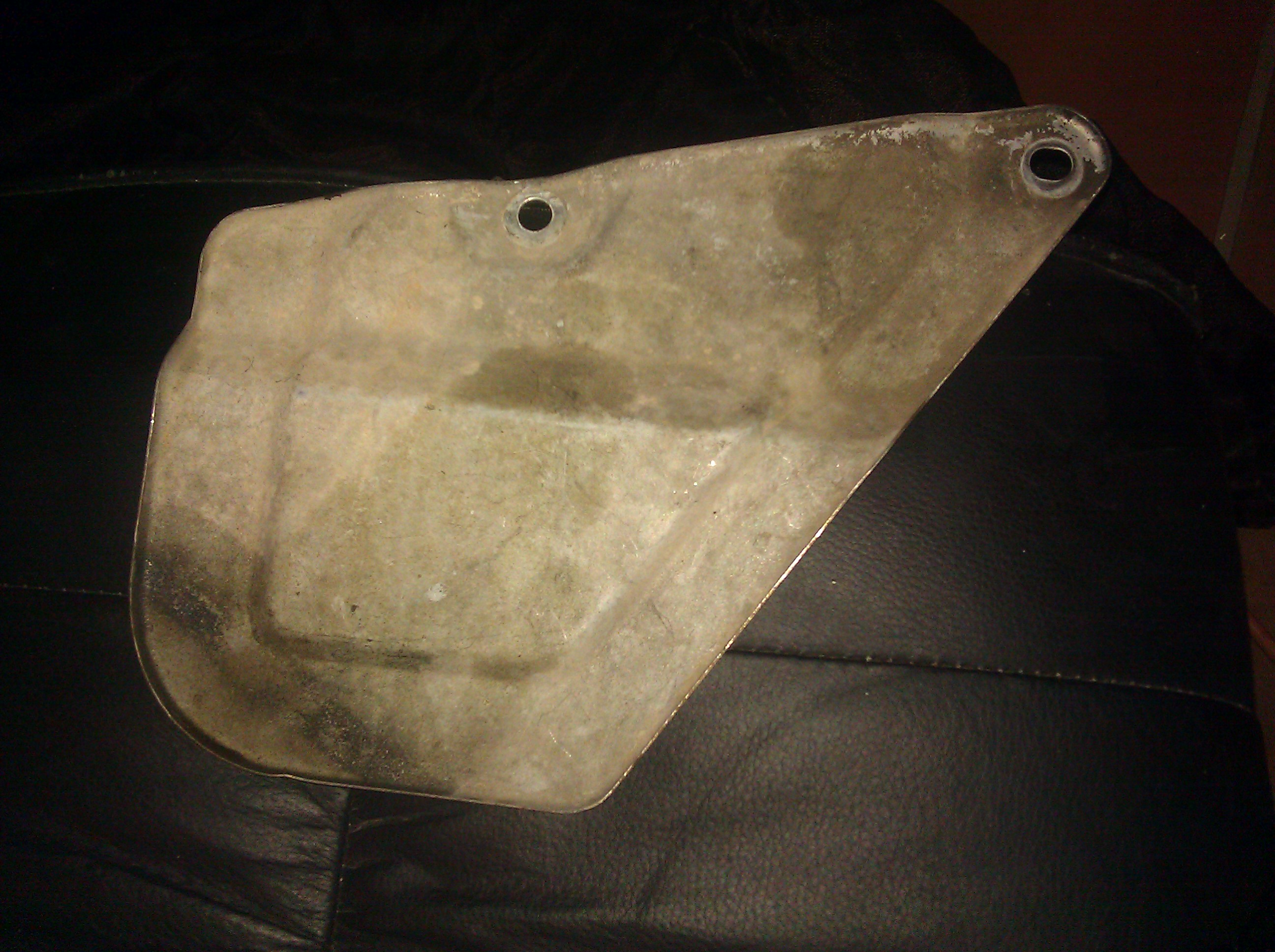

I can't find in any picture where this goes nor can I find it in the fsm...
does this even go on my truck? lol it could just be a piece of shrouding from something else but I doubt it....
Here's the pictures of the front and back of the tin piece.... I'm working on a 1988 single cab 4x4 efi 22re
Thanks

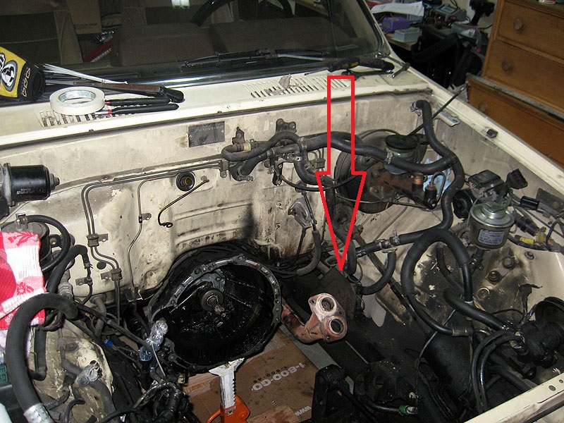

looks like this piece (not my truck, just found when googled)...attaches to the chasis, like a heat shield from the down pipe. Mine is a 92' and a different shape though.

strangely there is already a piece bolted on in that spot.... and is it the same shape? course not!
I wish I actually knew how many pieces of tin err whatever it's called is supposed to be on board this rig.... having extra parts after a job is always a strange feeling....
thanks for the pic though..... that's one of the few on the web I haven't looked at actually...(cruised a couple thousand pics this evening looking for anything that resembled.... most of the things I saw were for the exhaust manifold(again and again like it's the only piece of tin on the whole ride!) I typed in tin, heat shroud, heat shield, blah blah blah.... still got that same one... then I looked at finding post of procedures that had step by step photos... still never saw it once... and can't believe that the fsm (actually it's just a bentley manual) doesn't just have one of it's hundreds of pages dedicated to a line drawing of the heat shields... ugh..

top is the exhaust heat shield for an 80 on ebay, below is the heat shield off of MY 1980, in front of yours on the screen.

YES!!!! so does that mean that this is indeed a spare part from another truck? where does it go on your truck?

"worked on a 1st gen pickup lately???" yeah... I bought a scrapped out 85' as a gift for my 88 so I could have all the little things and an extra engine core etc.... someone had already robbed the solid axles off of it but then again that's a bigger project than I'm gong for right now.... just trying to get my stock 22re set up right....

mine goes exactly where the big red arrow points, my only guess is the reason they are different shapes (you said you have a non identical piece in its place already) is the body style change in 85, and as we all know in 1985 toyota was known to stick leftover 84 stuff in sometimes at the factory, so yea, if the bolt holes are in the same place, you have a spare if not, you have a ready to fab heat shield for wherever you want, or weld it to your roof and have a shark fin! lol!
