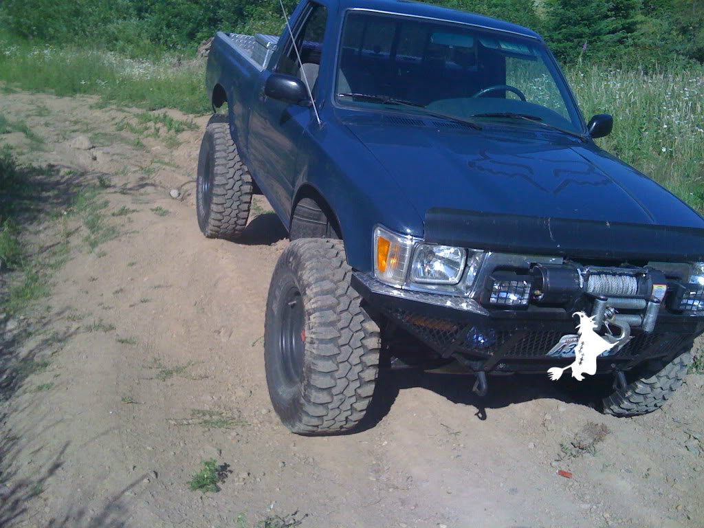

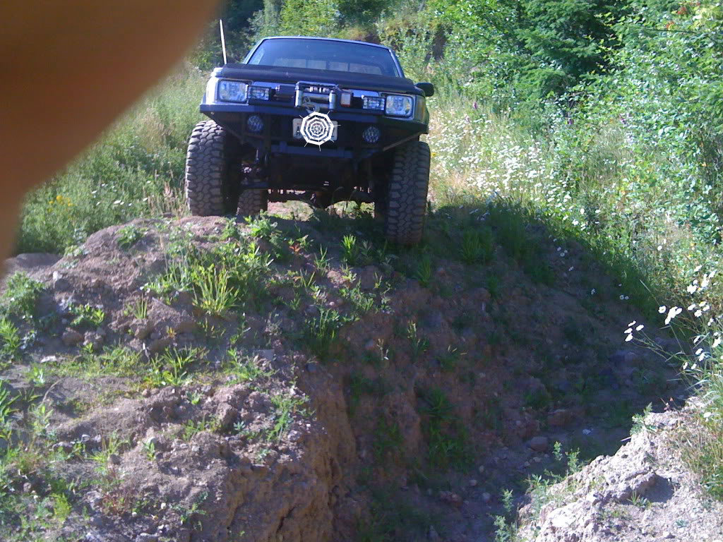

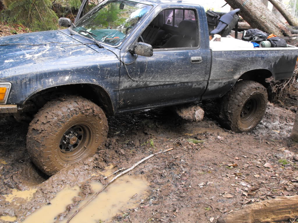

Theres another side to the argument.
Im not saying dont lift. But I didn't.
33's with 4.88 gears, cut fenders, and a rear spool. I was impressed every time I wheeled it.

And everybody is calling it the "pinch weld trim or mod" but really your just bashing the hell out of it with a big hammer so the tires dont rub.
You can combine a lift with fender trimming to fit bigger tires and the look you want.
But like highonpottery said, gears are a must.
