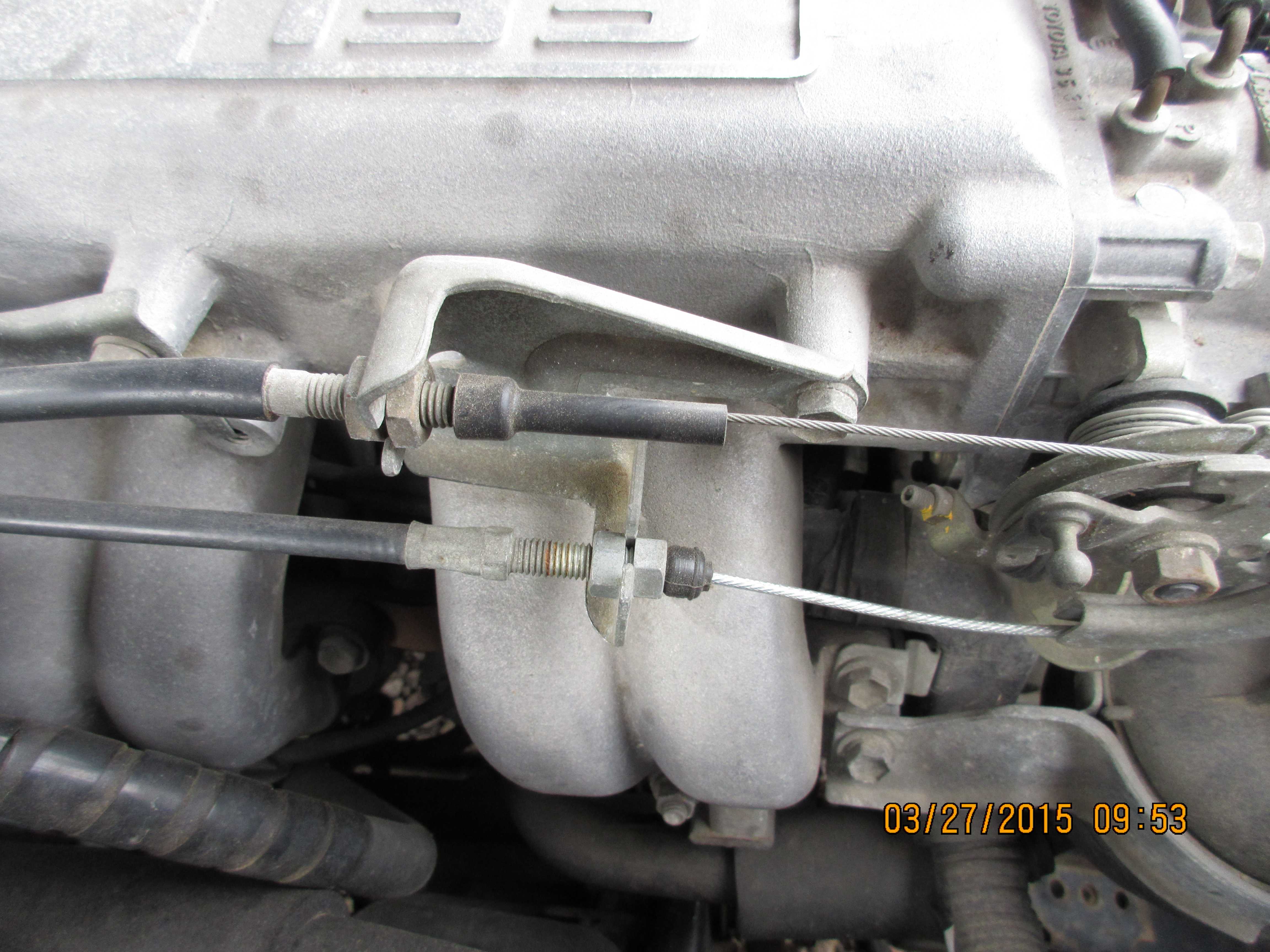

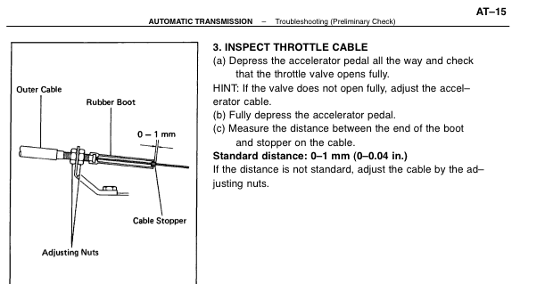

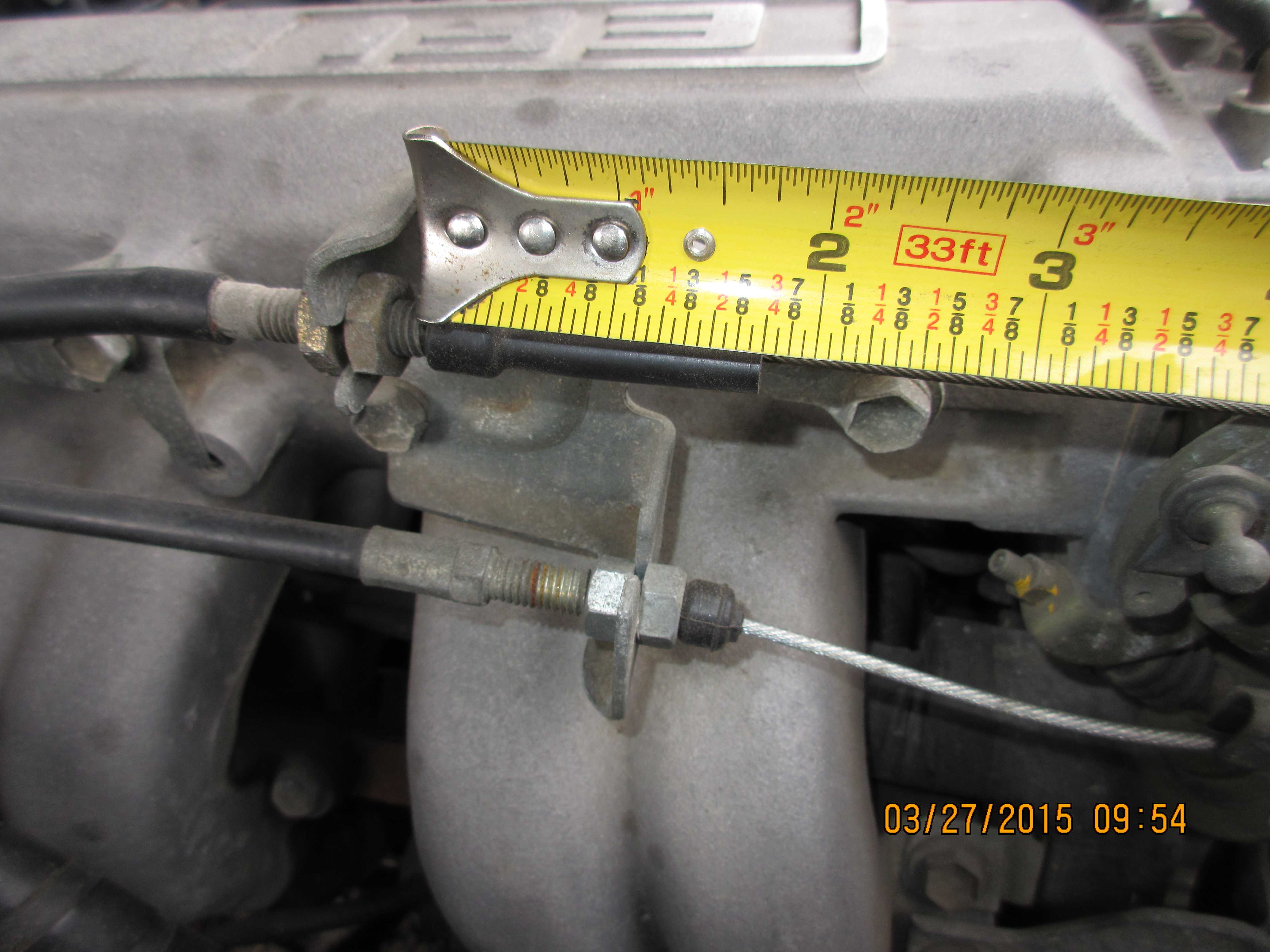

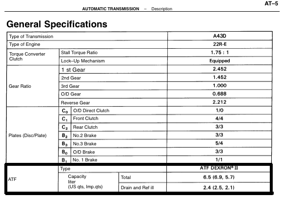

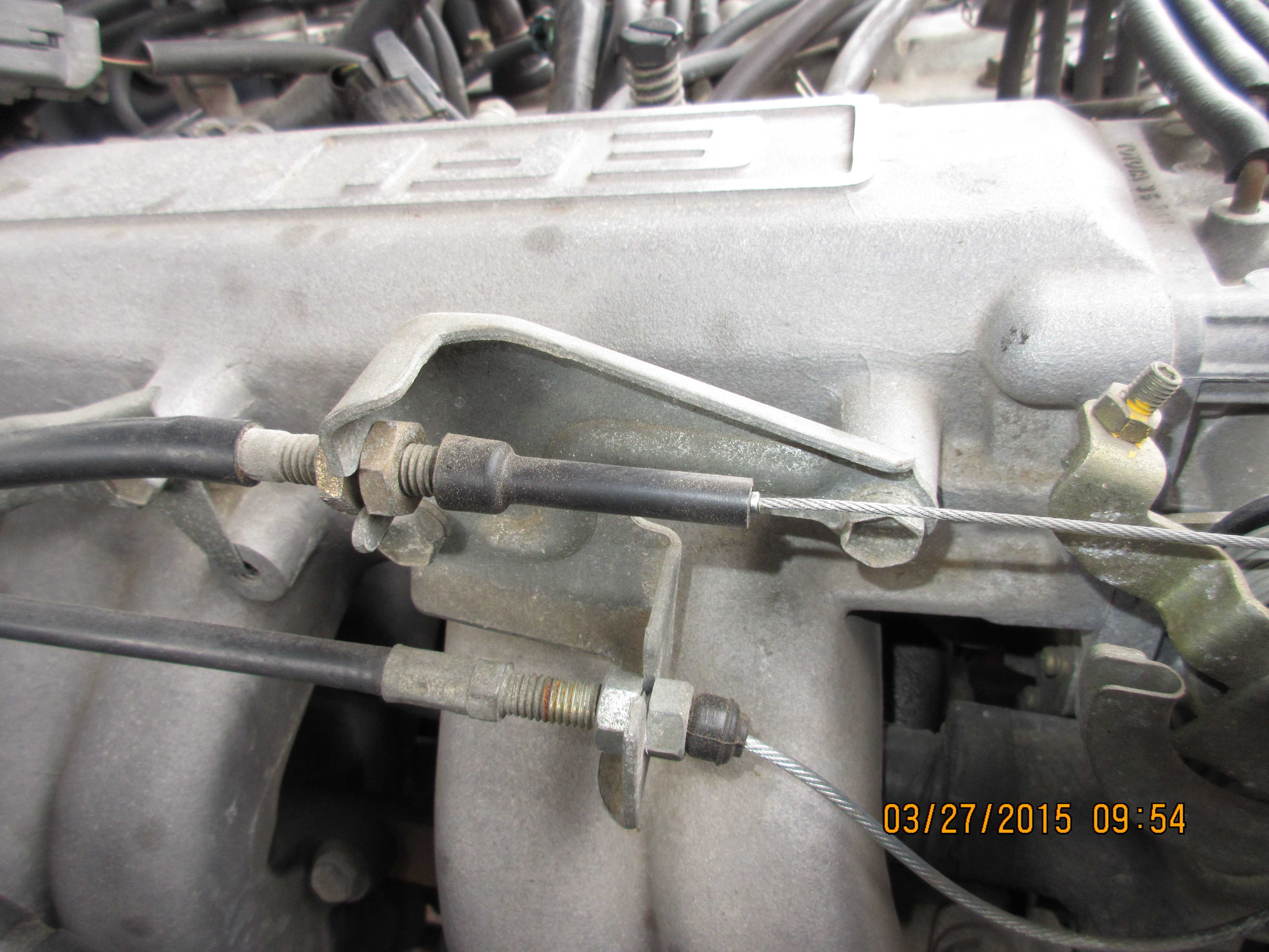

I just went outside and measured the rubber boot on what I had. Mine is a 94 Toyota pickup automatic with the same transmission.
Mine measures 1 3/4 inches. How many miles is on the RV? Just curious.
Here are some pictures as attachments.
I'm not sure if what you have is the same as mine. Good chance they are. Keep me posted.
Your problem could be a number of things. Has anything changed recently on the RV? Have you owned it for a while? or did you just buy it? (meaning do you know any history on it?) The main thing is don't get frustrated.
BE SURE TO CHECK THE CLIP THAT HOLD THE KICK DOWN CABLE IN, MINE WAS PUSHED BACK ABOUT AN INCH AND WAS MESSING UP THE ADJUSTMENT I THINK. Good luck!

Thank you very much!
I adjusted the cable. It seems to be better.
By the way, for some reason, my kickdown cable is on the bottom (where your throttle cable is) and my throttle cable is on top (where your kickdown cable is).
I also changed transmission oil and cleaned filter along with cleaning valve body. And lubricated the kickdown cable so it goes very smooth now.
But unfortunately I still have very late shift from 2-3 gear. I can control the shift by pressing the pedal and then at around 30-35 mph letting it go, so it shifts. My 1-2 and 3-4 are ok.
Still don't know what could this be...

I've read that it's possible that the kick down cable can stretch over time, like if the RV has a bunch of miles on it. I suppose anything is possible.
You may want to play with the adjustment (even if you have already) to see if maybe by "over adjusting" the cable may help. A little adjustment is alot though with this cable.
Back when I had my problem more than one person told me it was probably the kick down cable, I even read it in the service manual but it was in adjustment (or so I thought) so I kept skipping over that. It ended up being my problem because the kick down cable was riding up on the firewall about an inch. I fixed the routing of the cable and re-adjusted and it shifted like new.
I ended up realizing that I caused this problem by moving the kick down cable when I was trying to access my transmission dipstick. How many miles is on your RV? Is it like 2-300k miles?
The other culprits might be a damaged valve body inside the transmission but is kinda rare with these transmissions unless they've had the crap run out of them and caused them to get really hot and overheat. These transmissions do go bad but they take a beating.
The main thing is check over things. It can get frustrating I know. By the way you describe it, I wouldn't think the transmission is bad.

Hi toyotaman!
I did my best adjusting the cable. I did a fake rubber boot for the cable by attaching some scotch on the short rubber boot that was left. I found the best position for the cable and it's about the size you gave me 1 3/4 ". Thank you for it again! I did the adjustment on the road, so I can check it right away.
So, 1-2 is almost perfect now! Because of it, I actually felt how cable makes the difference. Huge difference!
But 2-3 is still not shifting properly. I would actually say that it doesn't shift at all until after you leave the pedal!
Could this happen in valve body exactly in the place where 2-3 gear spring or area is?
