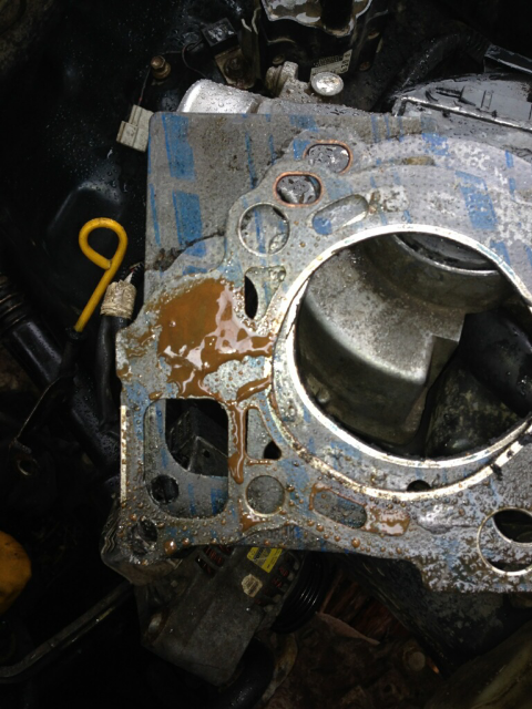

I finally got the heads off with the exhaust manifold and crossover pipe and also a good 3 foot piece of my exhaust going back under the driver seat. I didny want to risk breaking or stripping bolts that are not in a easily accessed place.
The gaskets looked really good and no scratches or anything in the heads or block. Number 5 cylinder definately had coolant in it but the rest didn't but I think it may have drained out past the rings.
There was some brown sludge on the passenher side head where the coolant passage goes through. Maybe coolant and oil that got mixed and sludged or something like that.
As you can see its on the gasket. I think its where it was leaking.

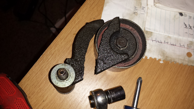

I got the heads back together and started the truck and it ran with a miss from a loose spark plug wire. The passenger side camshaft seal on the gear side was leaky really bad and so I took it back apart and used rtv to try to seal it since it was a new correctly installed seal. I went to put back on the timing belt and noticed it was hard to get on so possibly shrunk in the cold and then I broke the tensioner puller bracket.
I think it was already cracked since it was rubbing the fan attachment thing. It was probably bent too. But either way it was broke. Just adds to my problems and problems.
Anuone know a cheap reliable place to get a new one?? The bearing is fine too.
