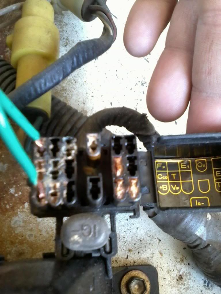

I pull the Return line and see if I am getting fuel thru the rail by jumping Fp and +B.
Fp +B Fuel Pump Test for 87 and newer. Use a paper clip for better results.
