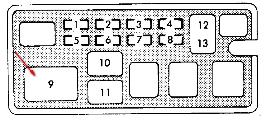

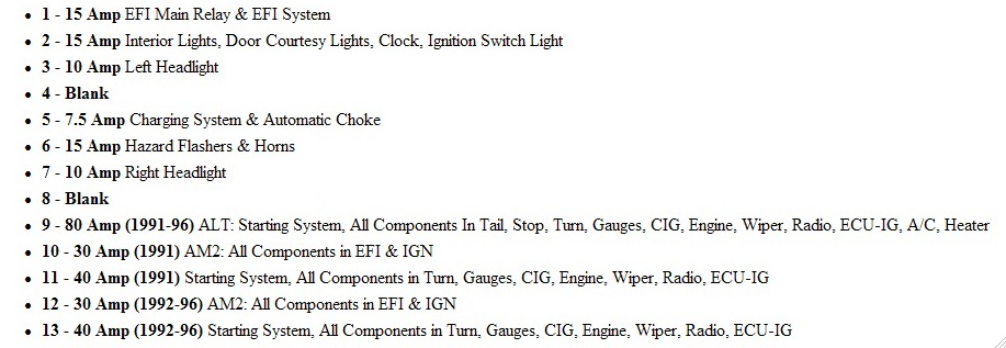

also check out these attachments, save them on your computer.
Hope this helps. Again; if you can keep me posted on what you find out.
Ignore the red arrow in the diagram lol.

So it appears it is the EFI box shorting out ? Is that the box inside the cab on the passenger side near where your feet will be, right side ? I hear aklot of relay clicking from it at times.
Ironically I need that 80 amp fuse you have a red arrow to, it was blown when the kid I biought it from hooked the battery up backwords. I have it jumpered at the moment.

Having that 80 AMP fuse jumped could be your problem. Check out the FSM it probably has information for this topic.
