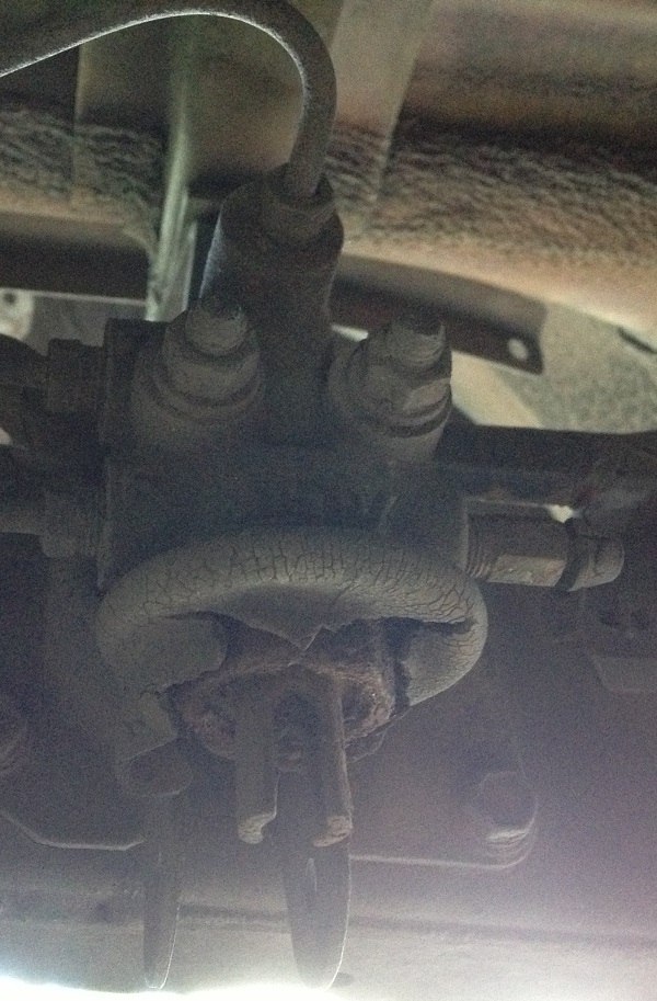

Yesterday I ordered about $450 worth of stuff from Rock Auto, with much more to come. I purchased a new front bumper, new bumper ends, new turn signal assemblies, new parking light assemblies, new tail light assemblies and a couple interior items. Now that that is out of the way (will post pictures of the new stuff as soon as it gets here) my truck has decided I need to spend more money on brakes. While troubleshooting the spongy brake syndrome, and bleeding the brake lines, I noticed a couple of fun things: The wiring harness from the master cylinder is screwed (both wires are cut) and the LSPV is completely rusted out. It doesn't even look like a LSPV anymore.

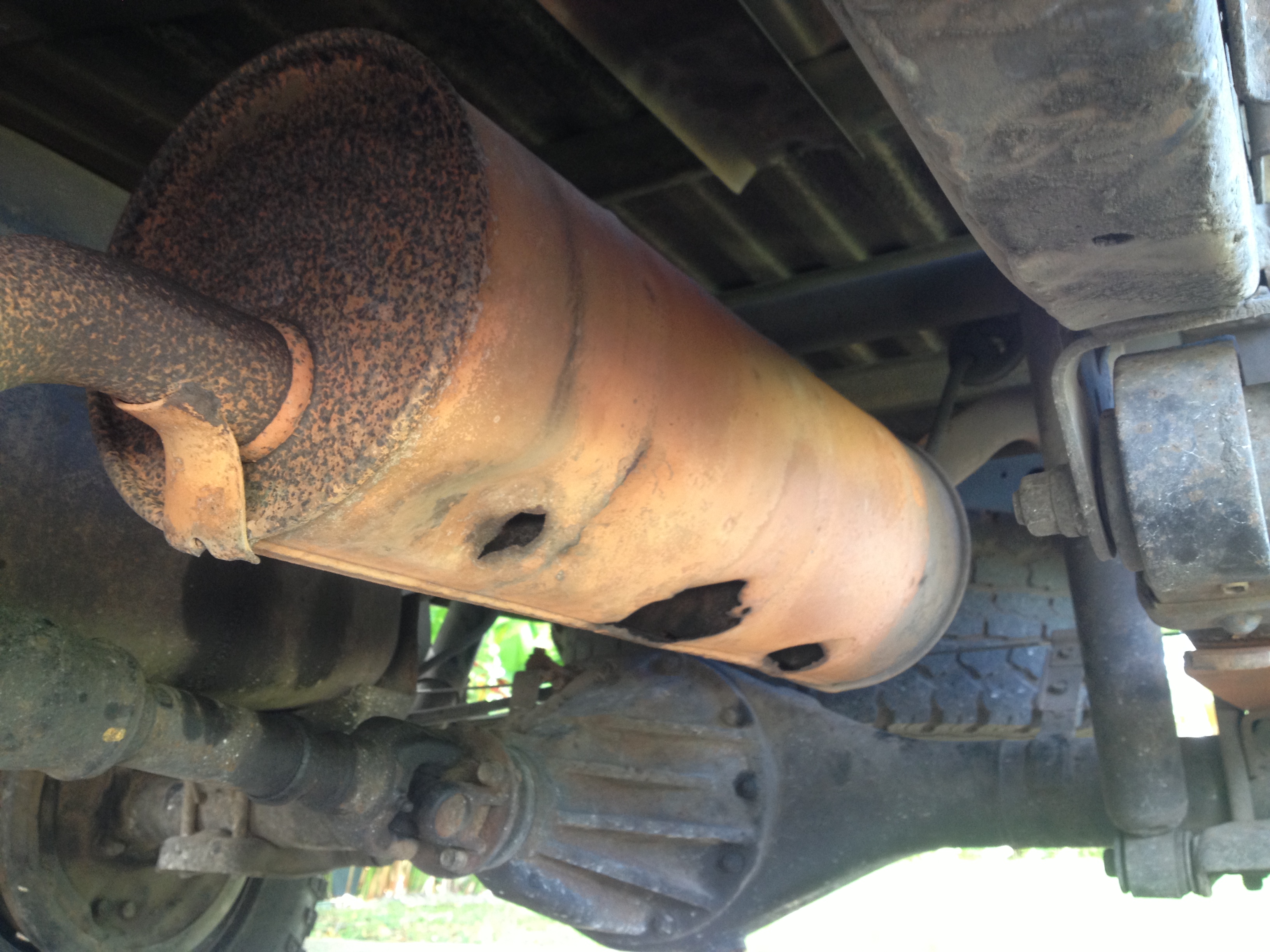

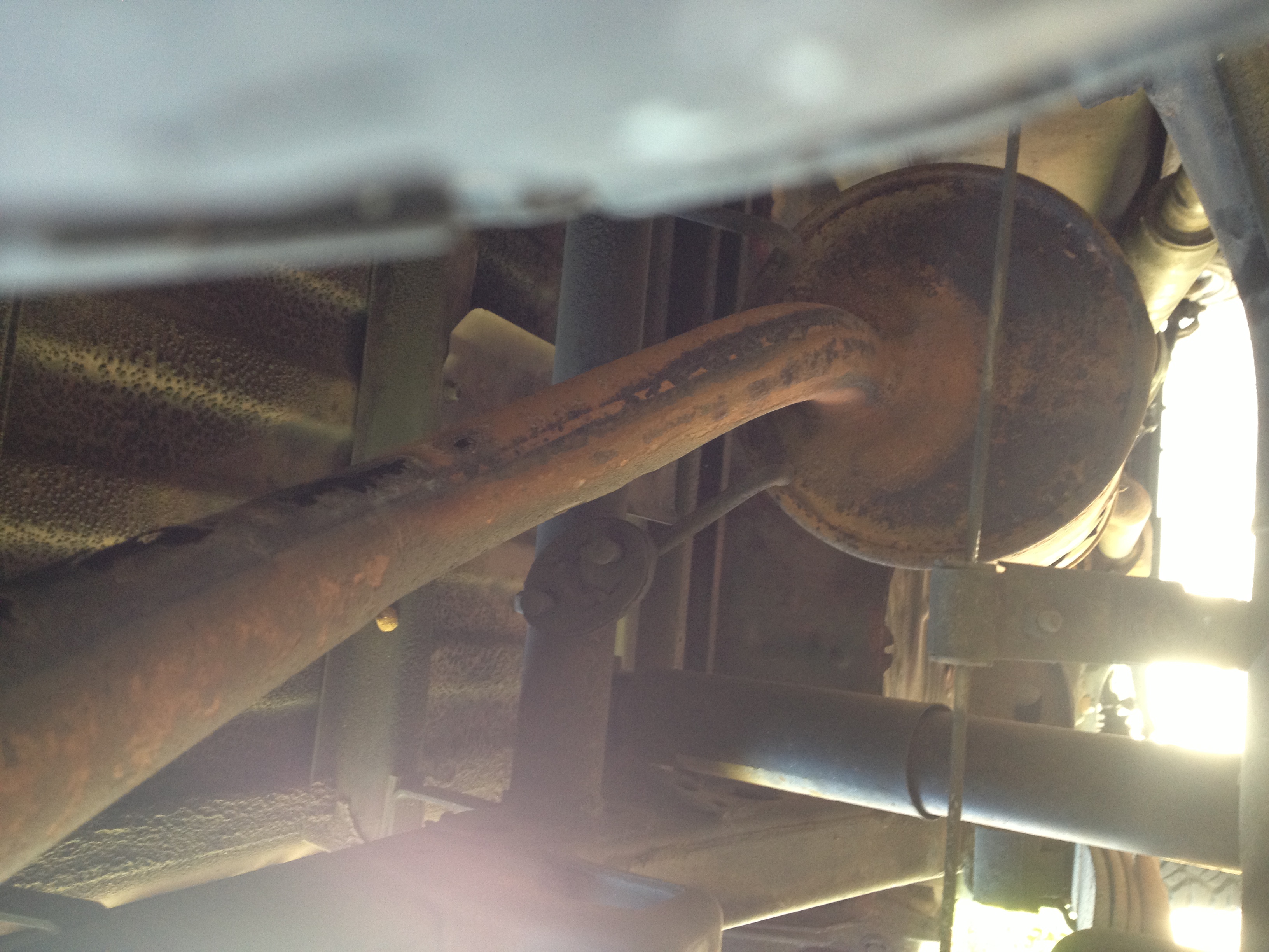

exhaust pipe / muffler / cat tear-out and replacement (all rusted beyond belief)

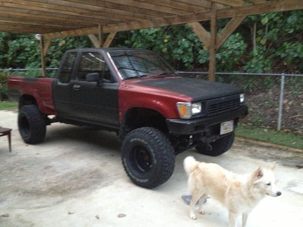

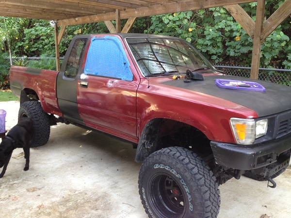

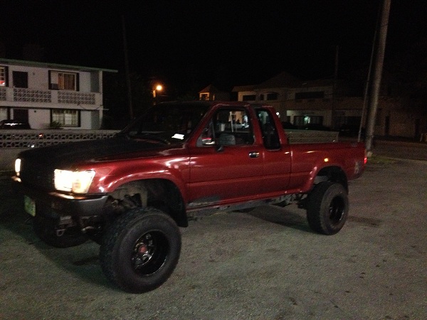

Alright, posted up some pictures, you can see a lot of the damage, anything red in those pics has been sprayed, those are about 4 months old. Later Ill post some pics of the artist formerly known as "LSPV" aka the reason why my truck is a lawn ornament.

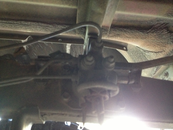

Edit: Here is the beautiful valve herself:

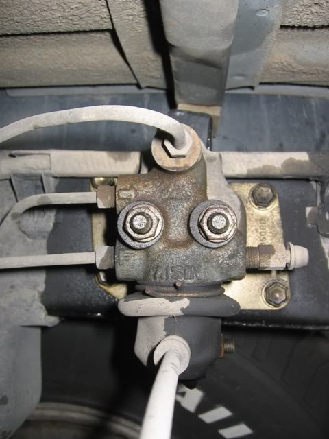

And what it is supposed to look like
So regarding this, I am thinking about going with a Wilwood manual valve, and installing it near the master cylinder. I searched around here a lot yesterday and it seems to be a decent option. The dealership out here in Guam wants $550 plus shipping for a new LSPV... Here is to hoping Wilwood ships to guam :/

I pulled the LSPV off today, splice the lines together where they should be, and plugged off the "T" by the passenger side fron wheel. Tomorrow I am going to finish pulling out the old return line, and clean up a few things underneath before I test it out.
