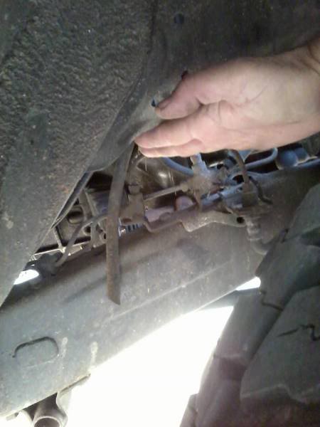

Here is a great place to disconnect your brake and clutch line. By the Passenger front tire.
