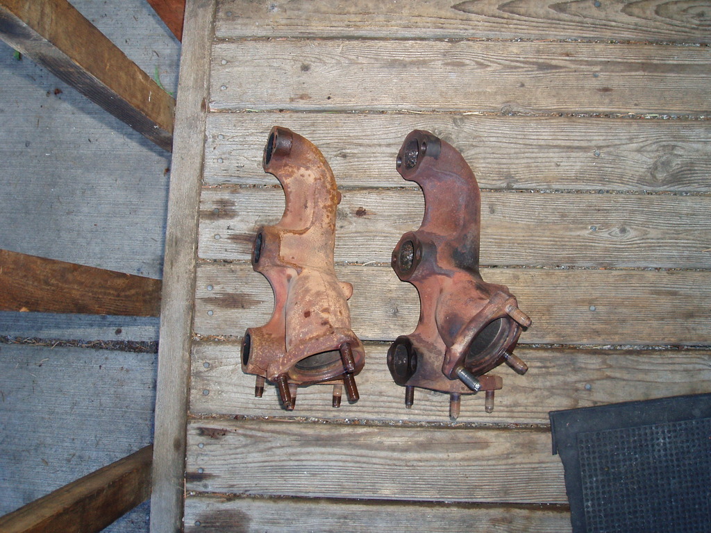

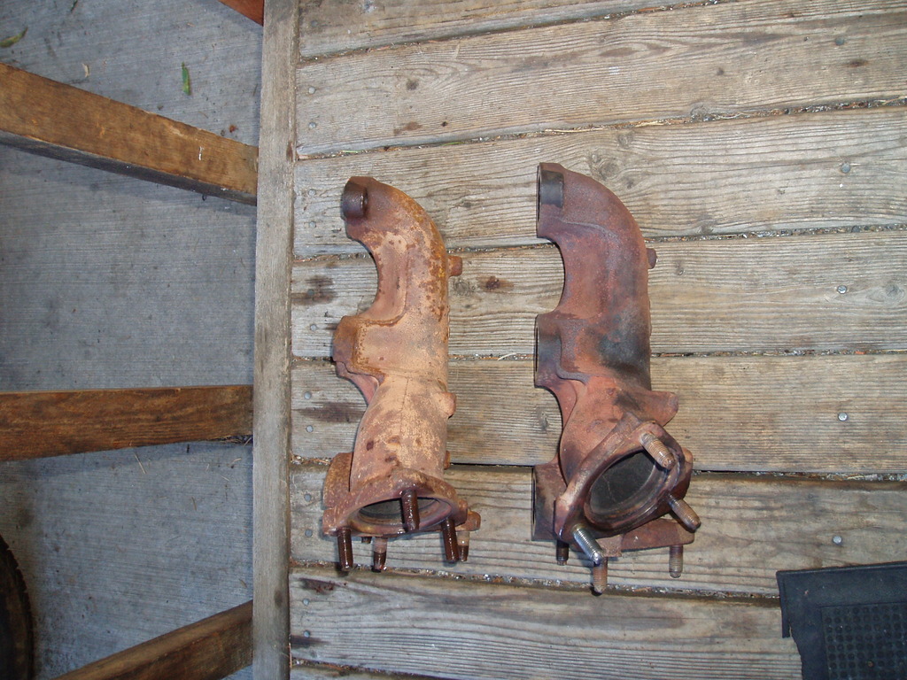

They're different. Did you know that? I didn't. Does it matter? It does if you want to use one in place of the other. No can do. Tail pipe won't bolt up. Angle of the flange isn't the same. Not even close.
88 to the left of 89-95

Well...you could do it I suppose...if you wanted to swap more parts to make it doable. But it's probably easier to just swap the left exhaust manifold.
