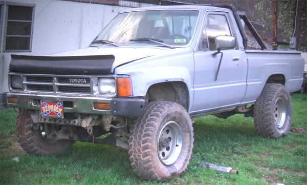

Hey Fella's I got a 88 Toyota 4x4 PickUp truck. About 3 Months back my motor started knocking an loosing power. I was coming up my DriveWay and my truck quit on me, Seemed like it just all of a sudden ran out of gas. So I was hell with it. I pulled it to my house and let it set for about a 3 weeks. I went back out there and tried to start it back up to go get some fire wood and it just set there and cranked and would not start. So i went an got some starting fluid and sprayed into the EFI. Well then it started but quiet. So I sprayed some more and started it back up. As long as I was spraying starting fluid in it. Then it would run. So about 4 weeks back I pulled the 22RE motor out and dropped a new 22RE down in it. And well I still got the same problem. Altho I got a new Motor LOL. So I pulled the fuel pump out and replaced it with another one i had lying around here. I tested my pump and Sure as hell it works. So I was Stumped. So i decided to run a straight wire straight to my feul pump to see if that would fix my problem. Well it didnt. So i poured some gas into a pop bottle and squirted it back into the EFI and well it will start an run until it runs out of gas. So would any of you people no what would be wrong with this. As long as i am running a straight wire to the fuel pump it works. Other then that it dont kick on. But even with a straight wire hooked to my fuel pump it still wont start without me pouring gas into the EFI. My truck has been setting now for 3 months with a new motor in it and wont even start. Really is starting to piss me off. So I would greatly appreaciate any help that I can get. Thanks Alot.
